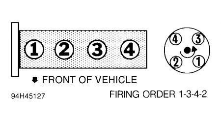

What is the firing order?

Hi John,
Here is the firing order. Check out the diagrams (Below). Please let us know if you need anything else to get the problem fixed.
