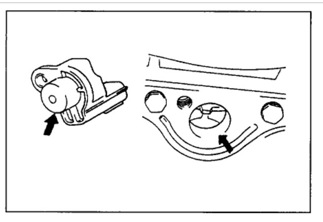

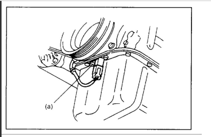

Your mechanics are wrong about the crankshaft angle sensor giving a code when it goes out. This is the first sensor we change when these kinds of problems occur.
Here is a guide that will give you an idea on what you are in for when changing the sensor.
Here is a diagram of what it is like on your car (below)
