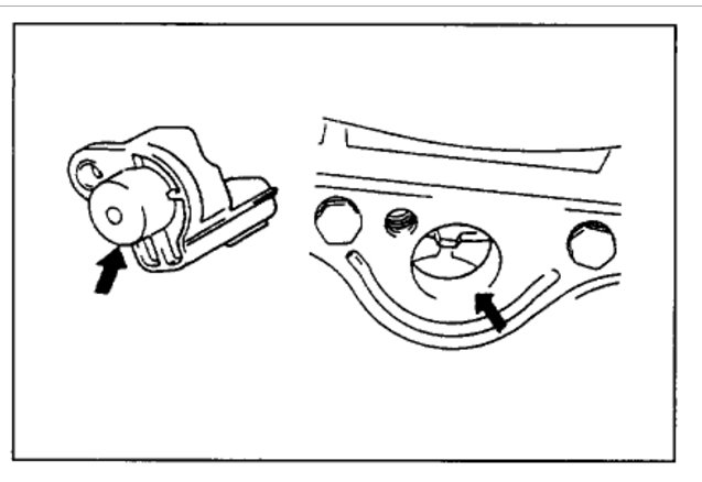

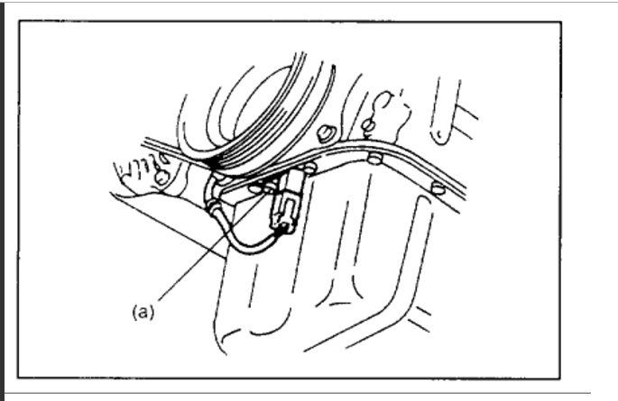

Hi we have exactly, or very similar problem. I am a motor mechanic from old days so not quite up with computers in cars. If we travel at no more than 2800rpm we can hold off the problem a bit longer. As Kath says the vehicle begins by just "dragging" a bit, this takes a bit of intuition as my wife doesn't notice this part but having experience and a lot of driving history I notice, almost like a lean mix in old type vehicle, then the miss comes on suddenly, very aggressive like more than 1 cylinder, rev counter dancing down to 0, and finally dead engine. It does not seem fuel related unless the lack of fuel also cuts the rev counter out which doesn't seem logical. Any aggressive driving brings it on sooner. I have been very suspicious of the crankshaft sensor but without the experience have not thrown it yet. Spent quite a bit of cash on diagnostic equipment but they all show no fault codes, which the mechs assure me would read up crank sensor fault if there was one. Any help would be good seeing it renders the wee machine dangerous in traffic seeing it can die at any moment. Cheers Clem
Aug 17, 2017 at 6:47 AM
  • 55,399 POSTS
Your mechanics are wrong about the crankshaft angle sensor giving a code when it goes out. This is the first sensor we change when these kinds of problems occur.
Here is a guide that will give you an idea on what you are in for when changing the sensor.
Here is a diagram of what it is like on your car (below)
