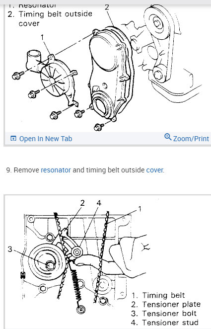

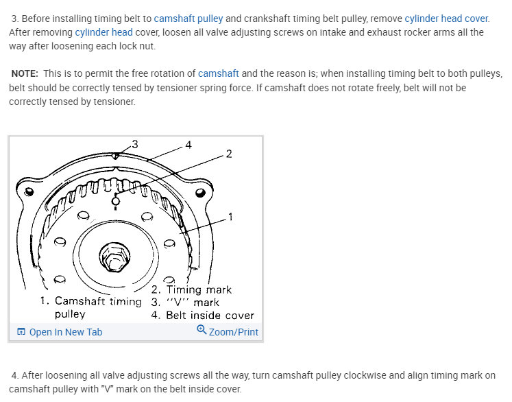

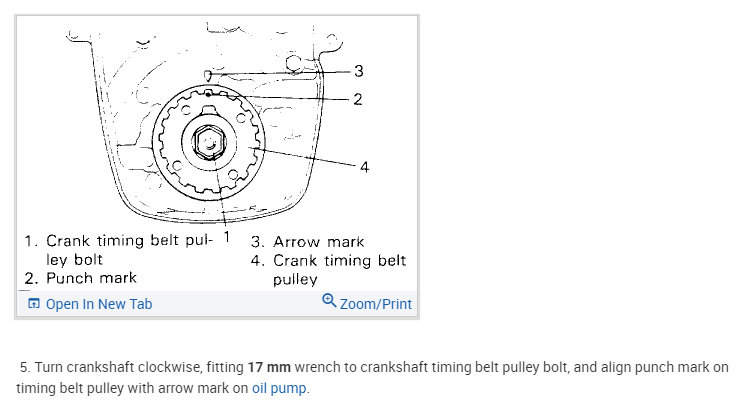

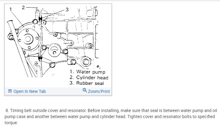

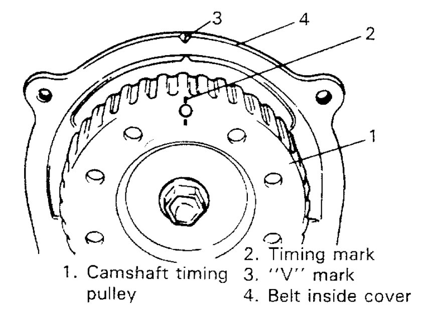

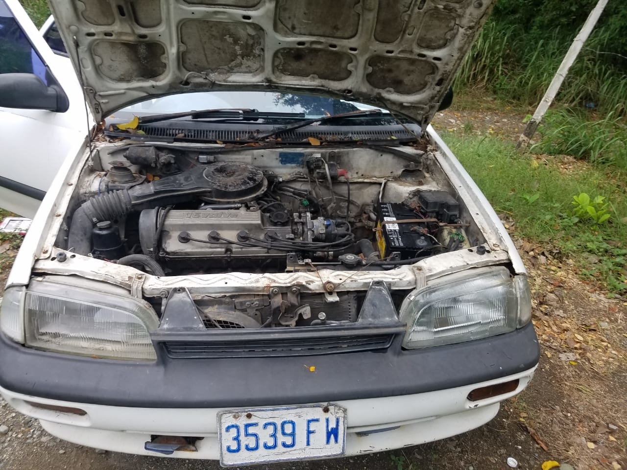

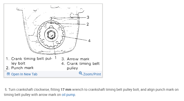

Is there any timing mark diagrams for the g16a engine and distributor timing?

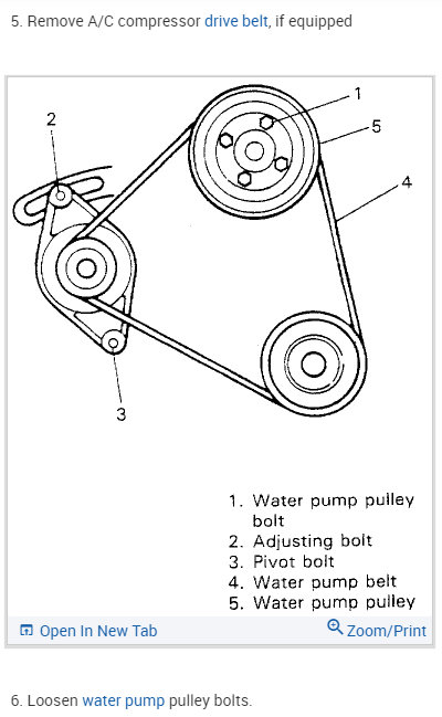

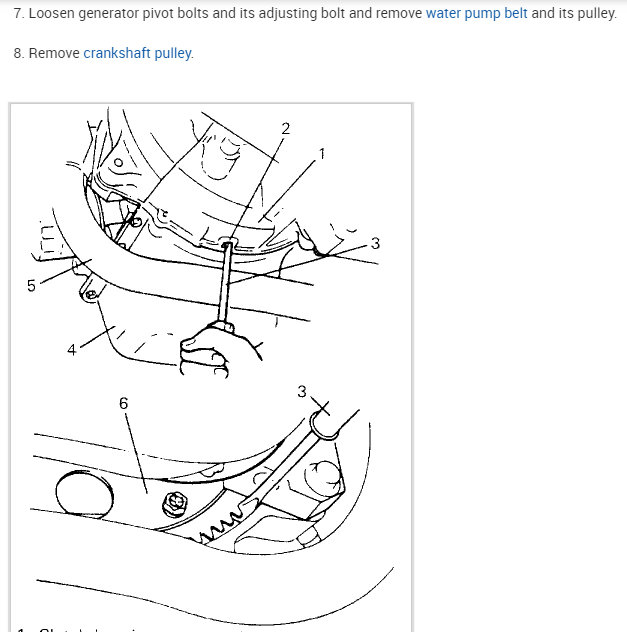

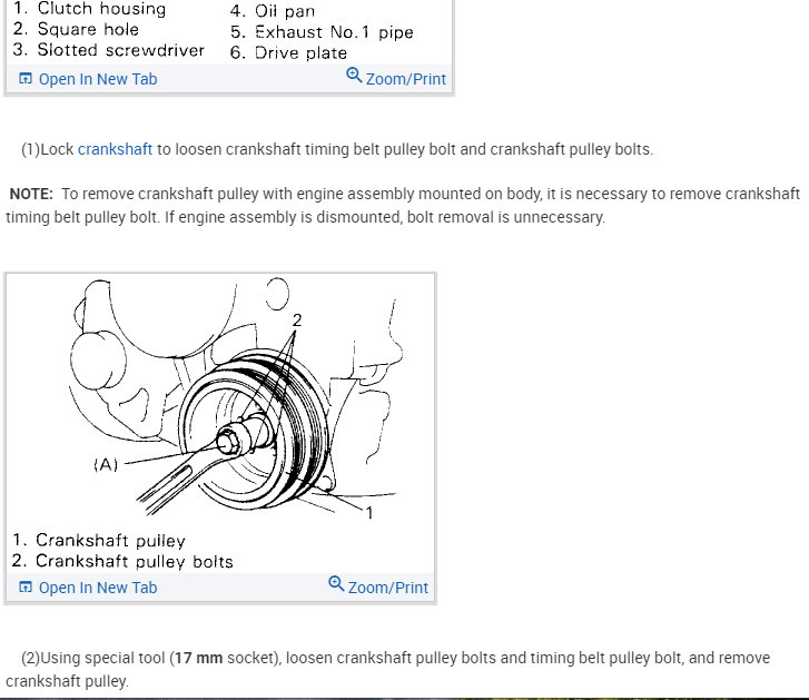

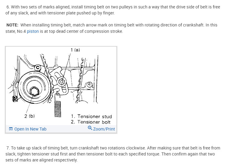

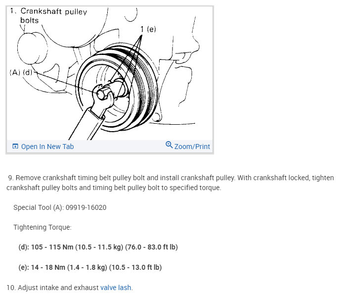

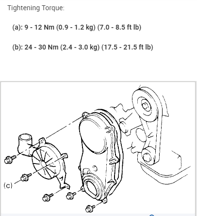

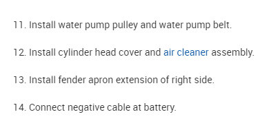

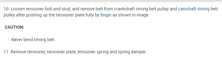

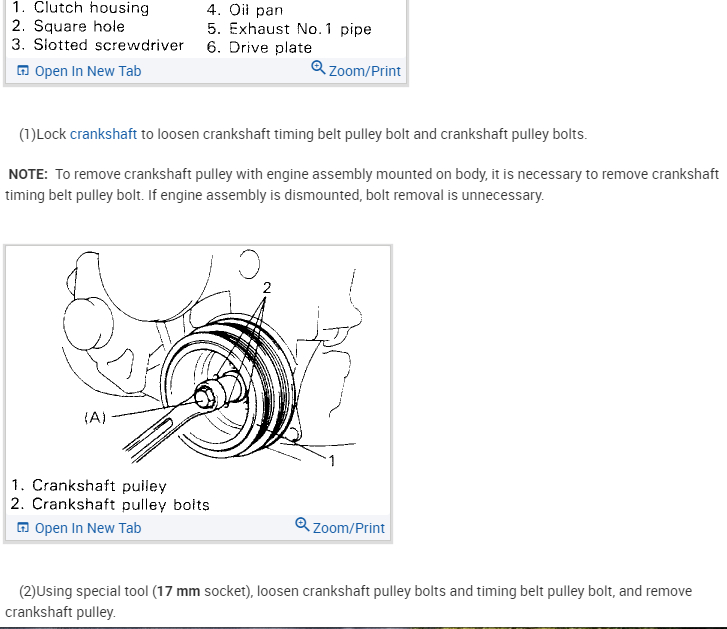

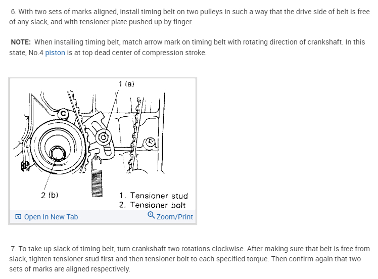

Hello, I'm Danny.
Here is a tutorial for you to view on how to remove/replace a timing belt:
https://www.2carpros.com/articles/how-a-timing-belt-works

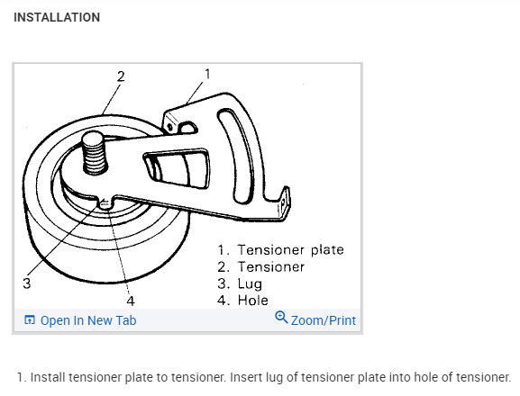

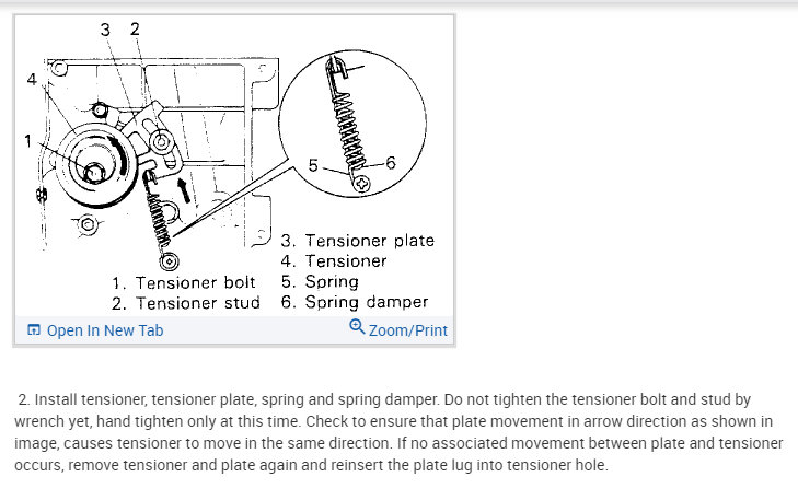

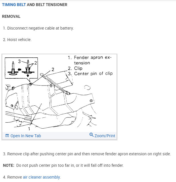

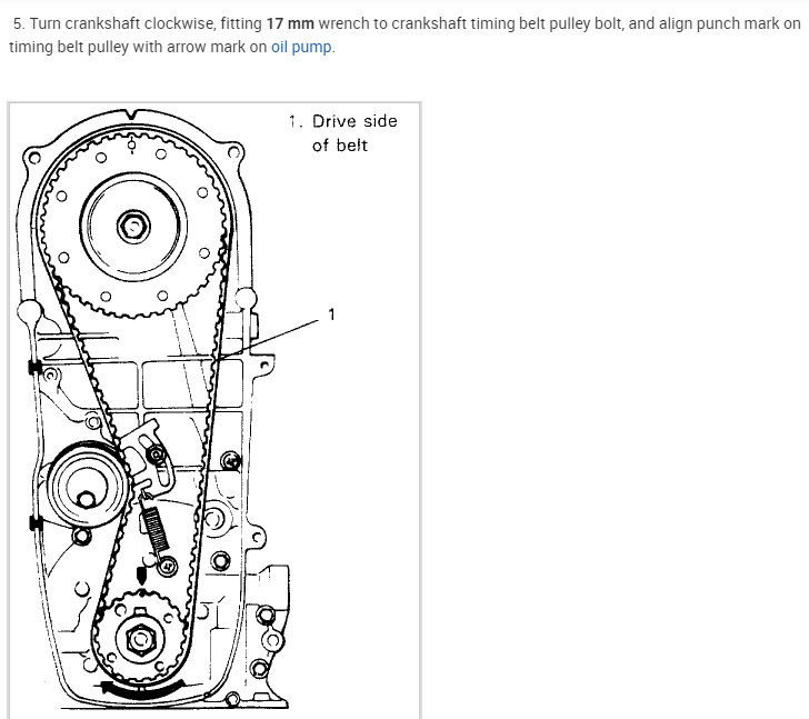

I've attached step-by-step instructions below including the timing marks for your vehicle.Hope this helps and thanks for using 2CarPros.

Thanks Danny this was very helpful.
