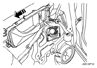

How do you replace the inside door handles
Feb 19, 2010 at 10:20 AM
DAVE H
  • 13,384 POSTS
Inside Door Handle Removal and Installation Removal Remove the door seal trim. Refer to DOOR SEAL TRIM REMOVAL AND INSTALLATION . Remove the tweeter speaker (if it is equipped) and the screw. Slide the door handle forward and remove it from the door. Disconnect the inside door handle and the lock rods. Installation Connect the inside door handle and the lock rods. Insert the inside door handle into the slots in the door. Slide the door handle rearward. Install the inside door handle screw. Install the door seal trim.

Would you mind pointing to the instructions for removing the trim around the inside door handle.
