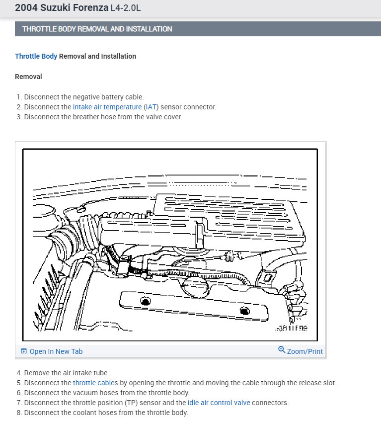

A good first step would be to check the fuel pressure when the engine cold. This can help determine the issue. With the key on and engine off it should have 55-57 PSI of fuel pressure.

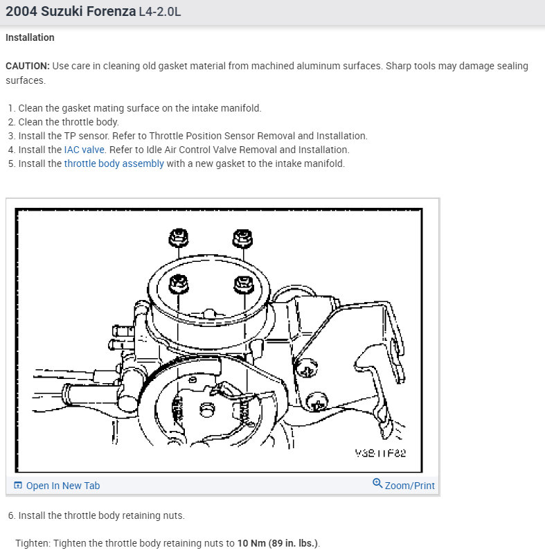

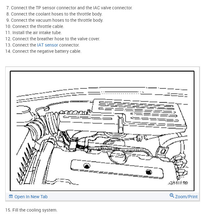

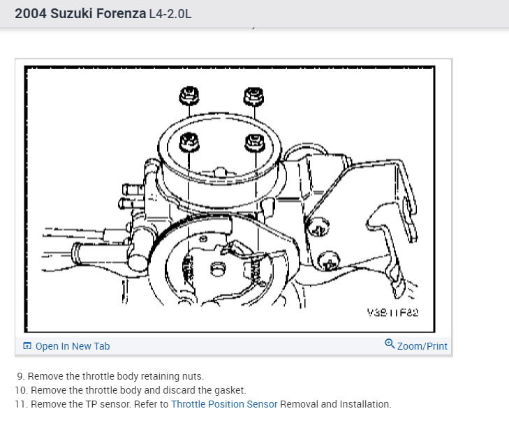

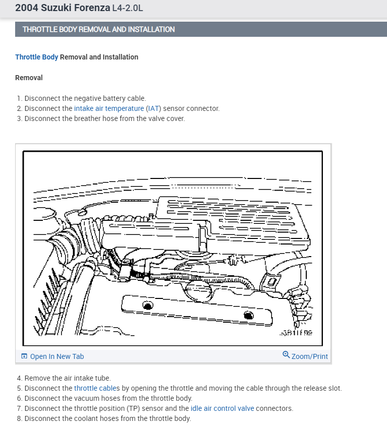

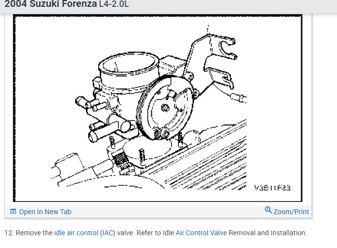

It will also be a good idea to check and clean the intake components like the throttle body and the mass air flow sensor.
https://www.2carpros.com/articles/mass-air-flow-service
