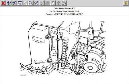

Thanks for reading my email and answering my ?.
Awhile back white smoke came out of my heater and air vents. now the switch doesn't work on any setting to the blower motor. Thanks again!
Dec 25, 2007 at 10:07 AM
  • 75,992 POSTS
Could be the blower motor or the blower motor resistor burned-up see resistor with the 2 screws.
https://images.2carpros.com/forum/automotive_pictures/12900_blower_motor_resistor_3.jpg
