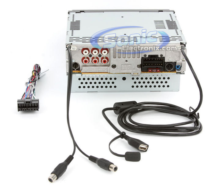

Now, I would like to buy a new unit. I've found this one, which seems nice:
http://www.sonicelectronix.com/item_18600_Sony-WX-GT77UI.html
The website say it will fit my car. However, the picture showing the back of the unit shows very different connections from what I saw in my car. I have a unique, very large wire harness (as shown on the wire diagram you've sent me) whereas the picture of the Sony stereo shows a small, "double deck" wire harness (see left of the picture).
Is this stereo really compatible? Which adapter do i need?

Here is a link to the harness you can get so you don't have to cut into the cars harness.They also sell radio's and install kit's check out what they have and let me know what you find.
Jan 18, 2011 at 12:51 AM
DAMOLITOY
  • 9 POSTS
Hey! I believe you forgot to post the link?
Jan 18, 2011 at 1:50 PM
SATURNTECH9
  • 30,869 POSTS
You got me on that one lol sorry about that here it is.
http://www.crutchfield.com/g_103000/Vehicle-specific-Wiring-Harnesses.html?tp=2977
