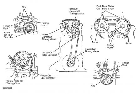

trying to time a esteem but cant find timing specifications marks.
Jun 21, 2009 at 9:41 PM
BLUELIGHTNIN6
  • 16,542 POSTS
1st Timing Chain marks..
https://images.2carpros.com/forum/automotive_pictures/261618_firstchain_1.jpg

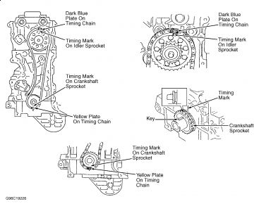

2nd Timing Chain marks..
https://images.2carpros.com/forum/automotive_pictures/261618_Graphic_47.jpg
