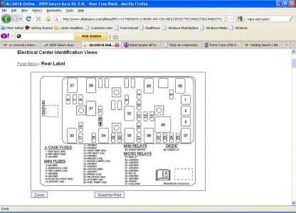

my problem is, when I pluged my phone charger in the cigerete lighter it blu out the cig.lighter & the radio,my Husband looked at the fuse box under the hood & could not find any bllown fuses, I had another Man that works at a car dealership look at it,He said that there is another fuse box somewhere but we can not find it anywhere in the car, could u please tell me where it might be & how to fix this problem, our owners manual is missing the pages that tell us were it is & it is a used car, thank you in Advance for your help in this matter..

https://images.2carpros.com/forum/automotive_pictures/416332_2000_suzuki_esteem_fuse_box_1.jpg
It's fuse number 20.
