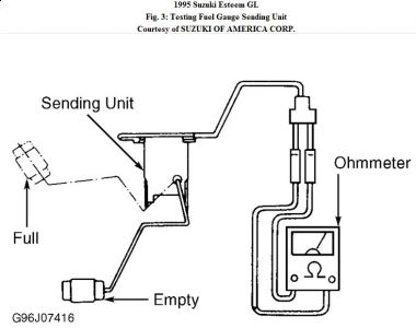

The sending unit is located in fuel tank and removal installation takes 2 hours. Fuel tank would have to be dropped to get at it. If low fuel warning lamp is equipped, you would notice a bulb type unit at lower end of sending unit and there would be 3 wires instead. FUEL GAUGE SENDING UNIT Remove fuel gauge sending unit from vehicle. Connect an ohmmeter between sending unit connector terminals. See FUEL GAUGE SENDING UNIT RESISTANCE . If resistance is not as specified, replace sending unit.

Thanks for sending the diagram. Do you have instructions on how to drop the fuel tank?

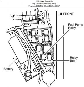

I am not ble to find any diagrams to show how to drop the fuel tank and would rely only on written instructions. 1 . Keep fuel level low before starting work to reduce the weight of the tank and also avoid spillage. 2 . Release fuel pressure FUEL SYSTEM PRESSURE RELEASE CAUTION: DO NOT perform this procedure when the engine is hot. Doing so may have an adverse effect on the catalytic convertor. a . Place transmission in Neutral (M/T) or Park (A/T). Set parking brake and block drive wheels. Disconnect fuel pump relay from relay box. Relay box is located between battery and shock tower.
https://images.2carpros.com/forum/automotive_pictures/192750_FuelPumpRelay95EsteemFig02_1.jpg
b . Remove fuel filler cap to release fuel vapor pressure in fuel tank. c . Reinstall fuel filler cap. Start engine and run until engine dies. After engine dies, crank engine 2 -3 times for about 3 seconds to dissipate fuel pressure in lines. To restore normal operation, reconnect fuel pump relay connector. 3 . Raise and support vehicle on stands. 4 . Use floor jack to support fuel tank. 5 . Remove fuel tank holding bolts. 6 . Lower fuel tank slightly and disconnect fuel, inlet and vacumn hoses. 7 . Disconnect wire couplers. 8 . Lower fuel tank 9 . Remove the fuel sending unit by removing the holding screws/nuts.
