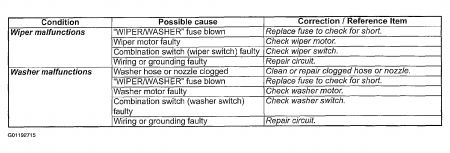

My wipers both front and back on my hatchback are not working. What could be the issue?

https://images.2carpros.com/forum/automotive_pictures/266999_suz_18.jpg
