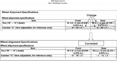

WHY DOES THE STEERING SHAKE & TREMBLE?
Jul 24, 2010 at 1:49 AM
MERLIN2021
Experienced Mechanic
17,250 POSTS
You may need an alignment and or steering parts or a tire balance, there are new alignment specs for this vehicle, take these to the alignment shop so it's done right.
