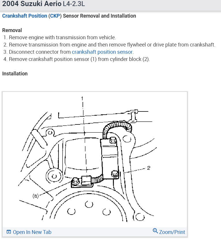

We are looking into buying a car for our daughter. It is a 2004 Suzuki aerio. The owner has taken it to many mechanics and they have not found any problems. However, the car wont start. It will crank and try to start but wont turn over. I am wondering what some issues could be before we buy the car and it becomes hopeless. Any thoughts?

It sounds like you have a crankshaft angle sensor that is not working here is a guide to help us get started please run down it and get back to us. You will need to remove the transmission to change the sensor :(
and to show you how to get the transmission out
https://youtu.be/6N6b5F2ChyE
Here is the crankshaft sensor location as well. Check out the diagrams (Below). Please let us know what you find. We are interested to see what it is.
Cheers

Wow what a crappy design it fixed the car but it cost me $750.00 to r&r the transmission.
