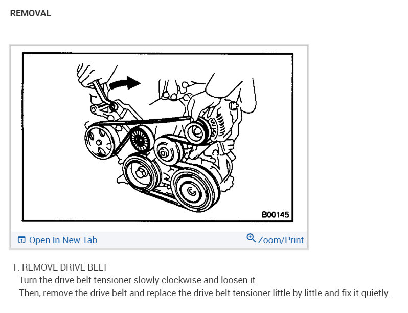

There's a whistling sound coming from the engine block and tapid cover. Battery is running dry weekly.

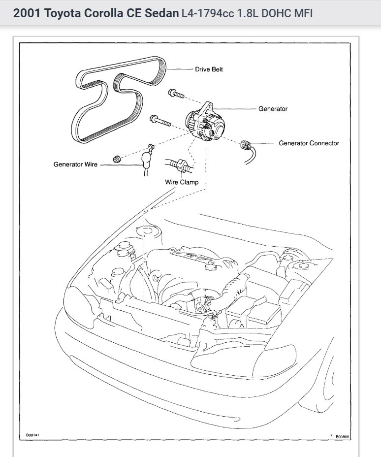

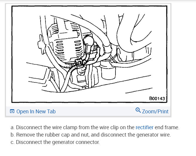

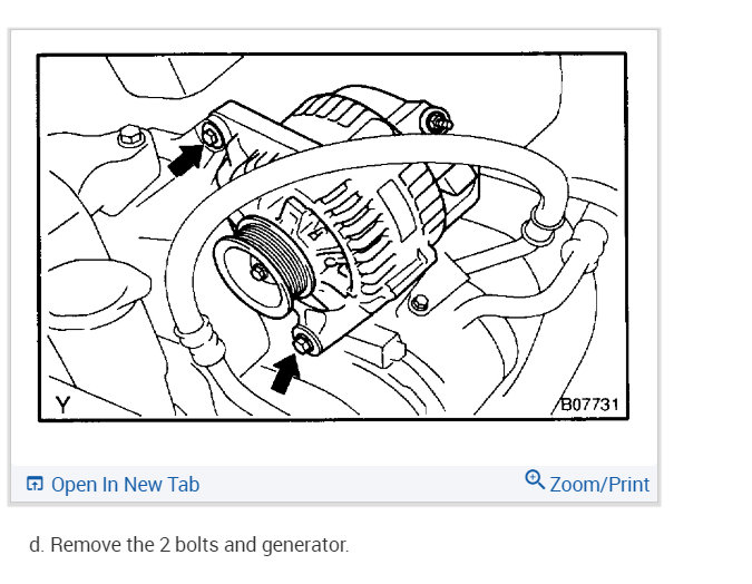

Yep, it sounds like the alternator voltage regulator is not working. here is a guide to help confirm the issue with step by step on how to change it in the diagrams below:
