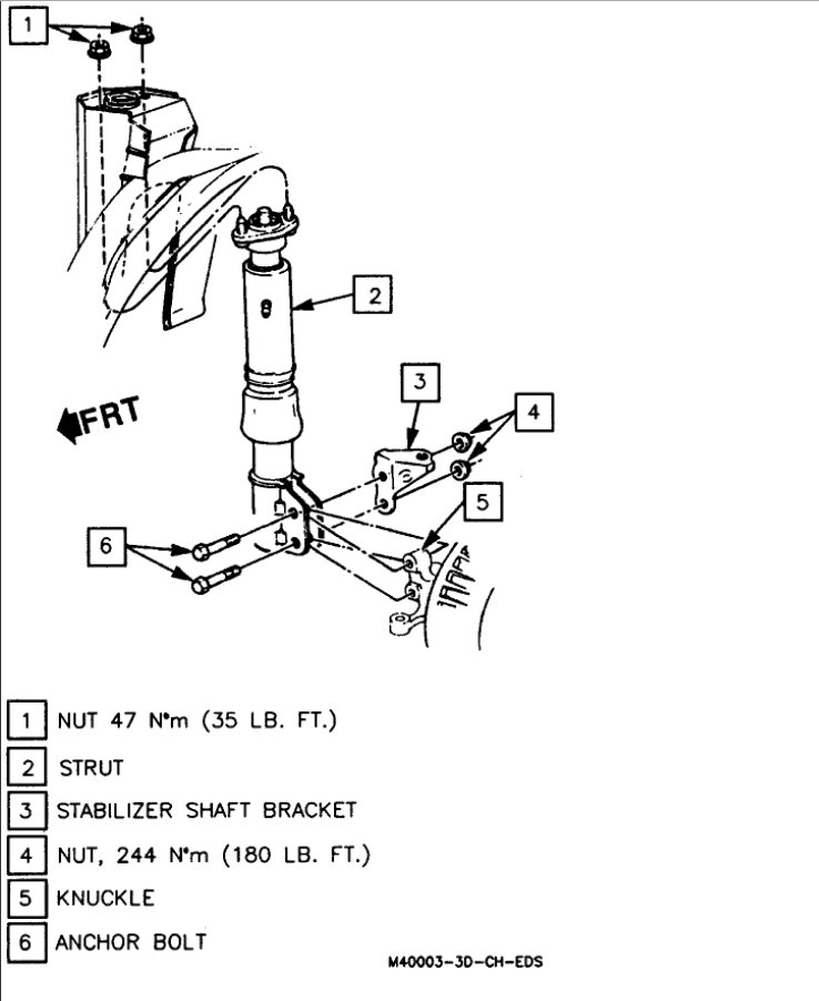

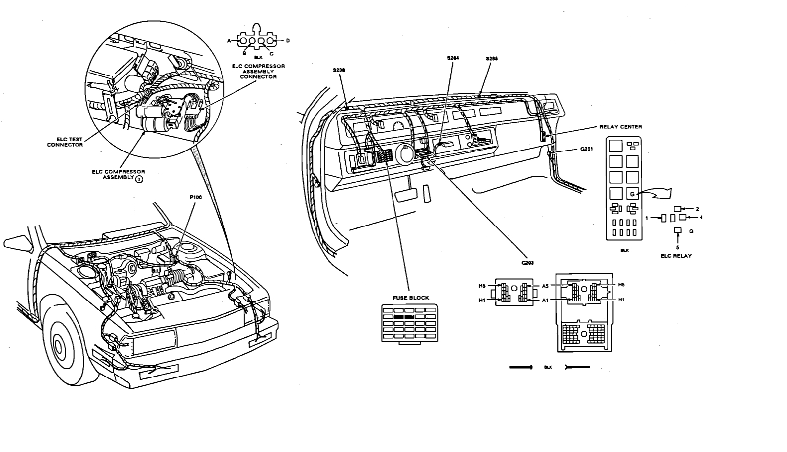

Does this car have struts, or ir shocks or what on the rear of it? if it has air pump where would that be at?
Oct 15, 2017 at 9:02 PM
Experienced Mechanic
55,694 POSTS
This car has air struts that look like shocks.
Here are some diagrams and a guide that will help you see whats going on:
https://www.2carpros.com/articles/replace-shock-absorber
