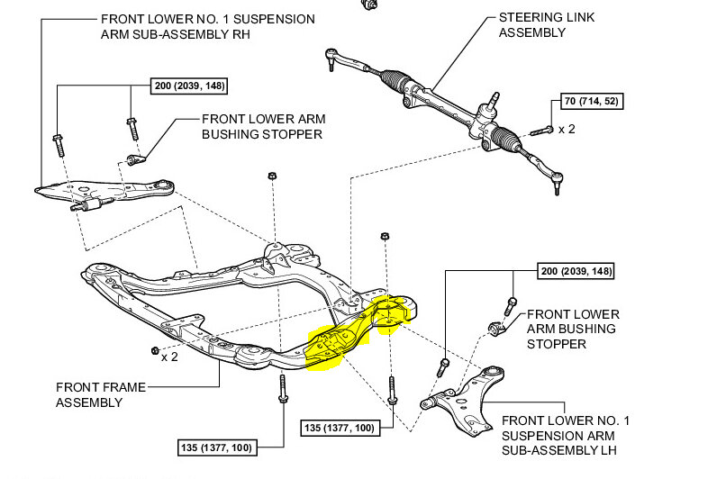

Have you had the vehicle aligned? Caster is how far forward or rearward the tire sits. Also, you replaced the A-arm, did you inspect the front suspension member for damage? See pic 1. Check the highlighted areas for evidence of something being bent.
Let me know what you find. Also, if you haven't had the vehicle realigned, it really should be done.
See pic below.

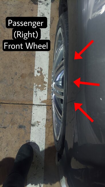

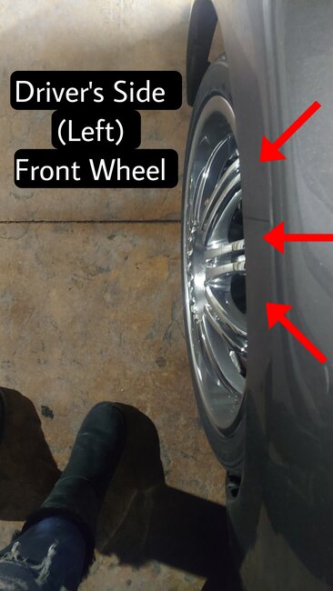

I agree the alignment is most likely off and getting it aligned will probably fix the issue with the wheel being pushed back since it's only a little bit now that I changed the arm but my problem now is my whole car is leaning to the left. Like the left side is sitting a lot lower than the right side. And my tires seem to be bent in at the top of the left ..the pictures I attached are the difference in the front left and front right. Could it be sitting low on the left because the struts went out?

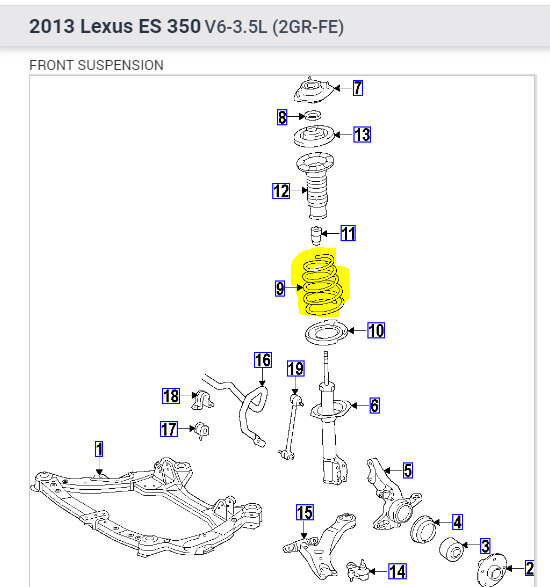

Have you checked the coil springs? See pic 1 below. Also, have you checked the strut tower where the top of the strut mounts?
Also, I did notice how the wheel is sitting in your pics. The idea that the top of the wheel is further in is an alignment issue. That tilt of the wheel is referred to as the camber. If you removed the bottom of the strut to replace the lower A arm, the alignment is off because that is where the camber is adjusted. That can be adjusted, but make sure nothing you replaced is coming loose.
I would suggest lifting the left front tire off the ground and confirming there is no excessive play in the tie rods, ball joints, and wheel bearing. Also, with the weight off the suspension, closely inspect the coil spring for evidence of damage.
