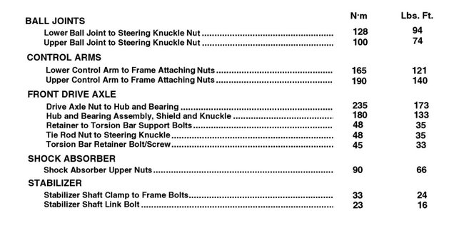

This is the first 4x4 with lift I've ever done suspension work. Lower control arm ball joint, upper arm, shocks, and such.
What are the torque values? I have a Chiltons for a Dodge Dakota; pretty sure that won't be accurate

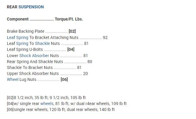

Good morning,
I attached below the specs for the front and rear suspension for you.
One suggestion, do all your torques with the truck on the ground with the suspension loaded.
