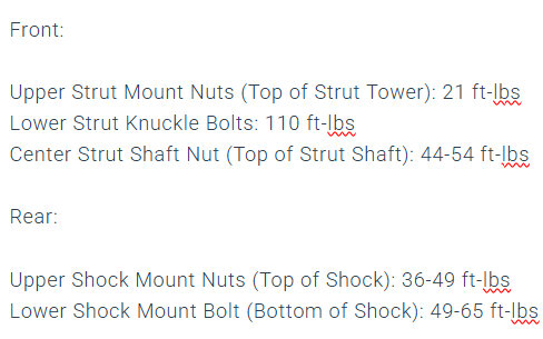

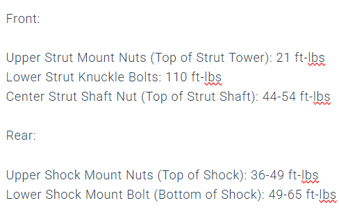

Hi, I am replacing the rear shocks and front struts. I’m trying to find the torque specs for both.

Sure, here are the torque specs for the front struts and rear shocks. Check out the images (below). Let us know if you need anything else.
