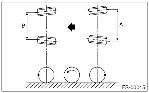

Toe is usually specified as slightly "toe-in", as shown in this drawing from Subaru. Road forces pull the wheels back to make them perfectly parallel to each other while driving.

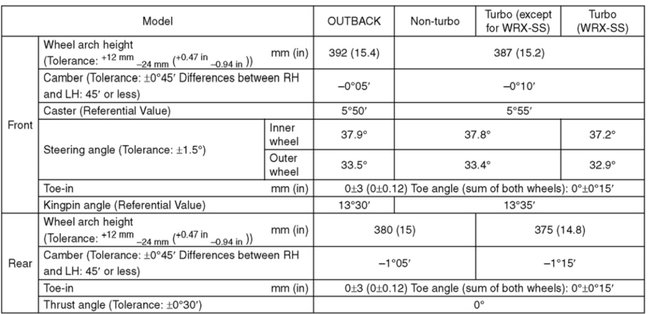

You should get a printout of the alignment that shows the "Before" readings that were taken automatically before any adjustments were made, and the "After" readings when the alignment was completed. You can use the second chart to compare to factory specs. Note that they show a negative sign with the camber specs. That means those wheels are tipped in on top slightly.
