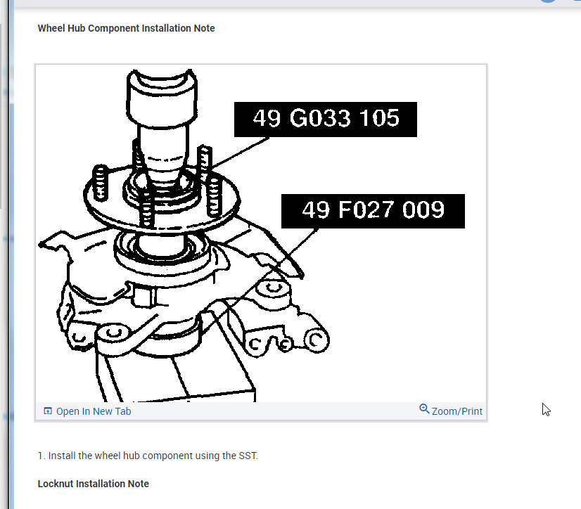

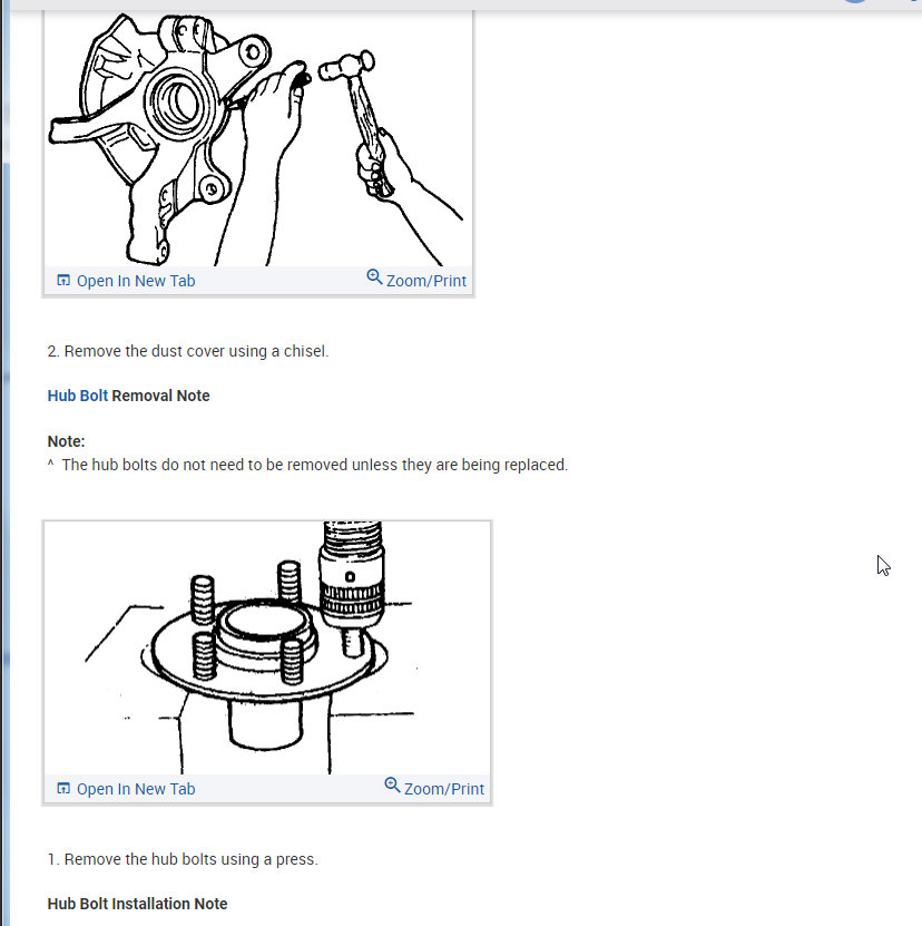

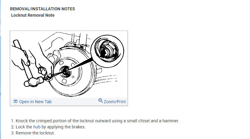

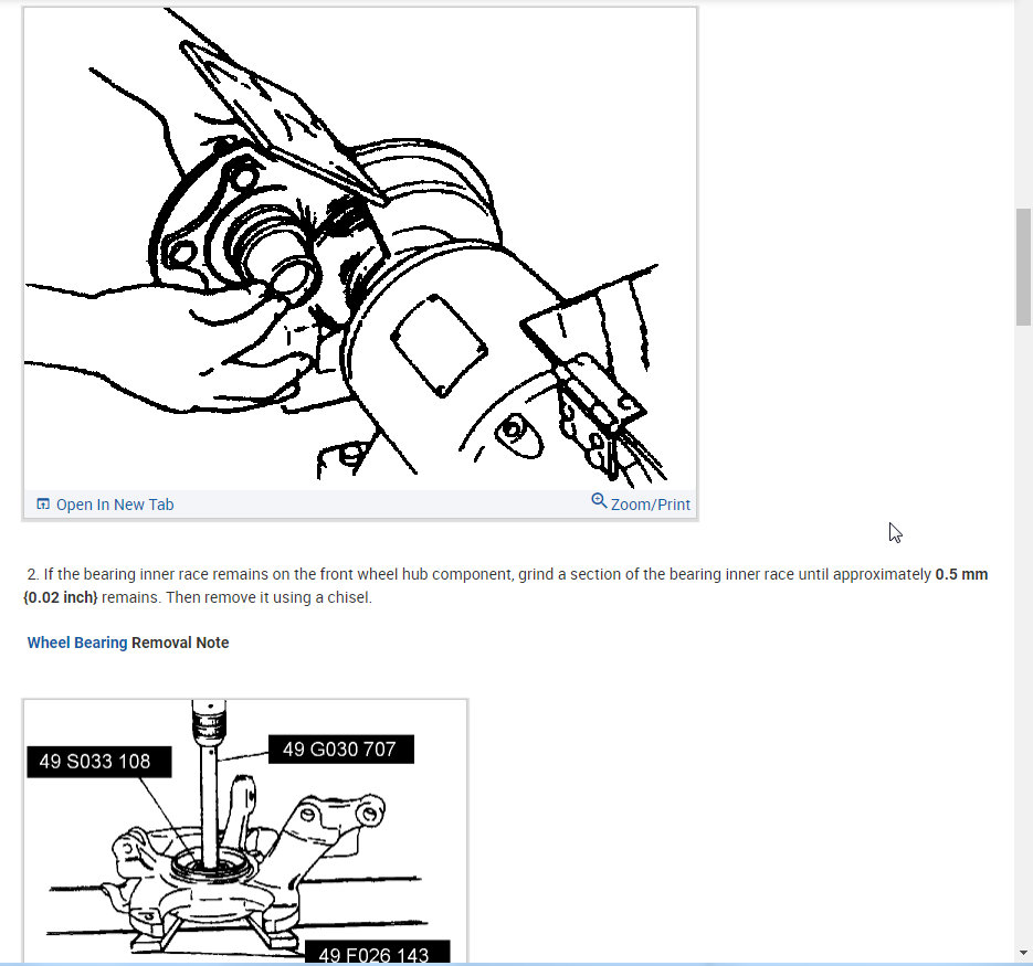

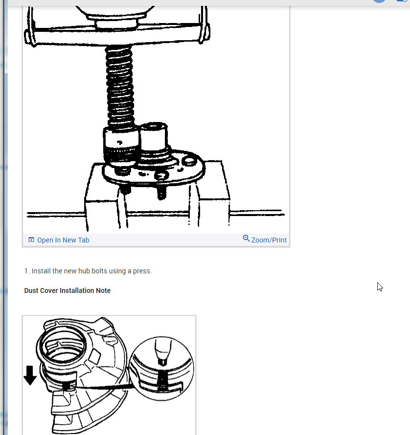

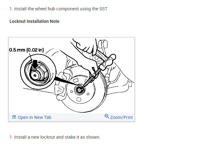

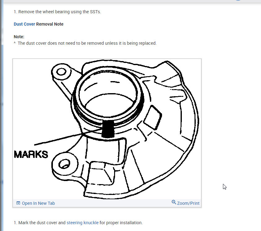

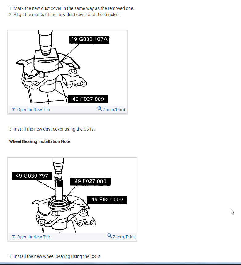

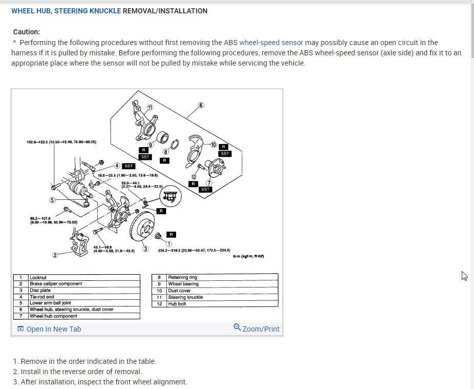

Can you get a video of this noise so that we can hear it? First and foremost I suspect this is a wheel bearing and if it sounds this loud then we need to make it a priority to get it fixed because it can do more damage the longer it goes.
Here is a guide that will help with this as well:
https://www.2carpros.com/articles/bearing-hub-replacement
Below you will find the process on how to replace the hub bearings from the manual but if you can get a recording of it we can try and confirm this.
Also, can you get the noise to start happening and then swerve back and forth and see if it gets louder and quieter. If so then that is usually always a bearing.
Let us know and we can go from there. Thanks
