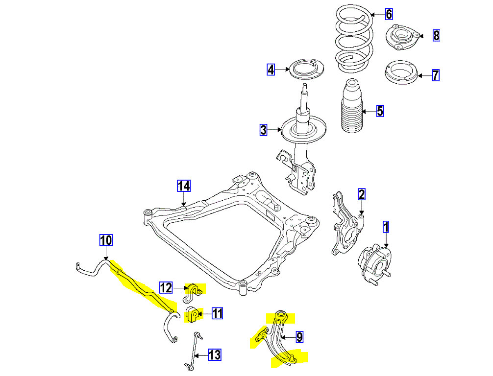

The noise only comes for the first 6-8 miles and them disappears almost completely. I have got the struts, Stabilizer links and bushing, caliper bushings and tires changed. Absolutely clueless what that could be. The local mechanics seem more interested to make money.

I did hear it. It sounds like something is loose. Keep in mind, I'm not there to hear it, but it sounds like a rattle. Your second video, is it the in and out movement you see in the axle you are concerned about? If that is the case, don't worry. They will move in and out a bit.
Considering all you have done on the front end, check to make sure there isn't a broken exhaust hanger or heat shield. I also have another question. Is this noise only evident when the vehicle is moving?
Also, when you hear the noise, does it stop or change when the brakes are applied?

Many thanks for your prompt response Joe. I understand it is difficult to ascertain the noise remotely. The strange part is the noise comes only for the first 5-6 miles and then disappears to a great extent. It comes only over uneven roads/bumps. To me it seems that overnight some lubricant accumulates at a point and when the car moves, it covers the joint again and the noise subsides.

Missed to mention. The noise is there with and without pressing the brakes. I recently got the caliper bushings changed. I am not technically qualified but basis google knowledge I have gained, do you think it could be control arm bushings?

I would think a control arm bushing would not go away. That is what is confusing me. It wouldn't hurt to check suspension parts. If you look at the attached pic, I highlighted things to check for play and to confirm they are tight. I realize you had new parts installed, but perhaps something is loose.

Thanks again Joe! Whilst the mechanics that I take the car to have said nothing is loose, however continues to get baffled as to why the noise comes only the in the first few miles.
