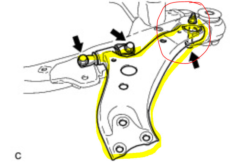

Usually with BMWs I can tell right away if one of the lower control arm bushings is bad as if I drive in the driveway even at 5 mph and hit the brake, I can feel the steering move an inch to the bad side due to the bad bushing. I cannot tell where the bashing is on this one. I don't see a lower control arm on this van.

There is a lower control arm. I attached a picture of it below. When you check it, pay special attention to where I circled. The retainer bolt is installed vertically through the bushing. If they fail, that is the most common place.
Let me know if this helps.
See pic below.

Installed lower control arms and stabilier links and all is good. Thanks
