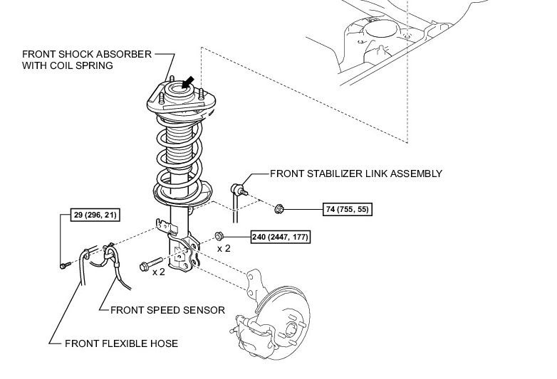

Because of our terrain road many times chassis becomes very near to ground causing some body harm.
Can do any suspension ride height modifications without performance or other problems?
Jul 7, 2020 at 1:54 AM
Good afternoon,
You could change the struts and springs but it will only lift it about 2 or 3 inches.
https://www.2carpros.com/articles/replace-shock-absorber
Otherwise, you would need to look into the road itself.

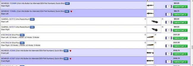

I attached the possible replacements for heavy duty.
