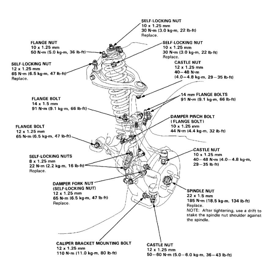

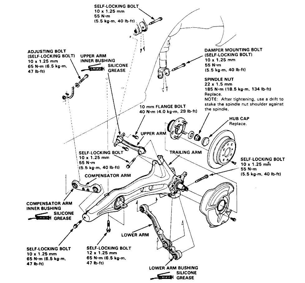

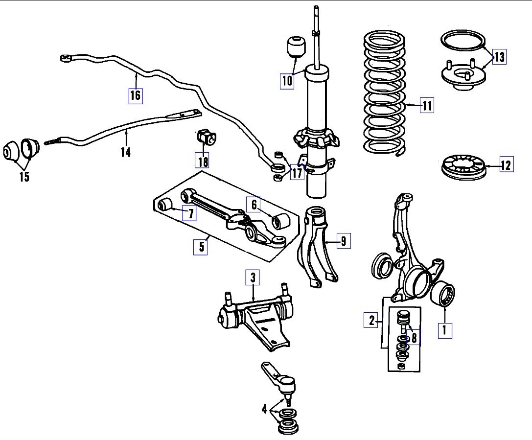

Are there any suspension diagrams rear and front for the car listed above hatchback that include all bolts, screws, and washers? Any sort of suspension diagram would help. I forgot which screw went where and with what. Any help would be appreciated.
Thanks

These might help. These are the main suspension components and most of the fasteners. Beyond those you would need the build manual.

This is exactly what I was looking for.
Thanks for the help.
