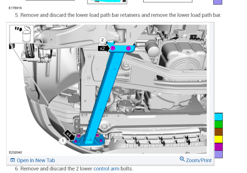

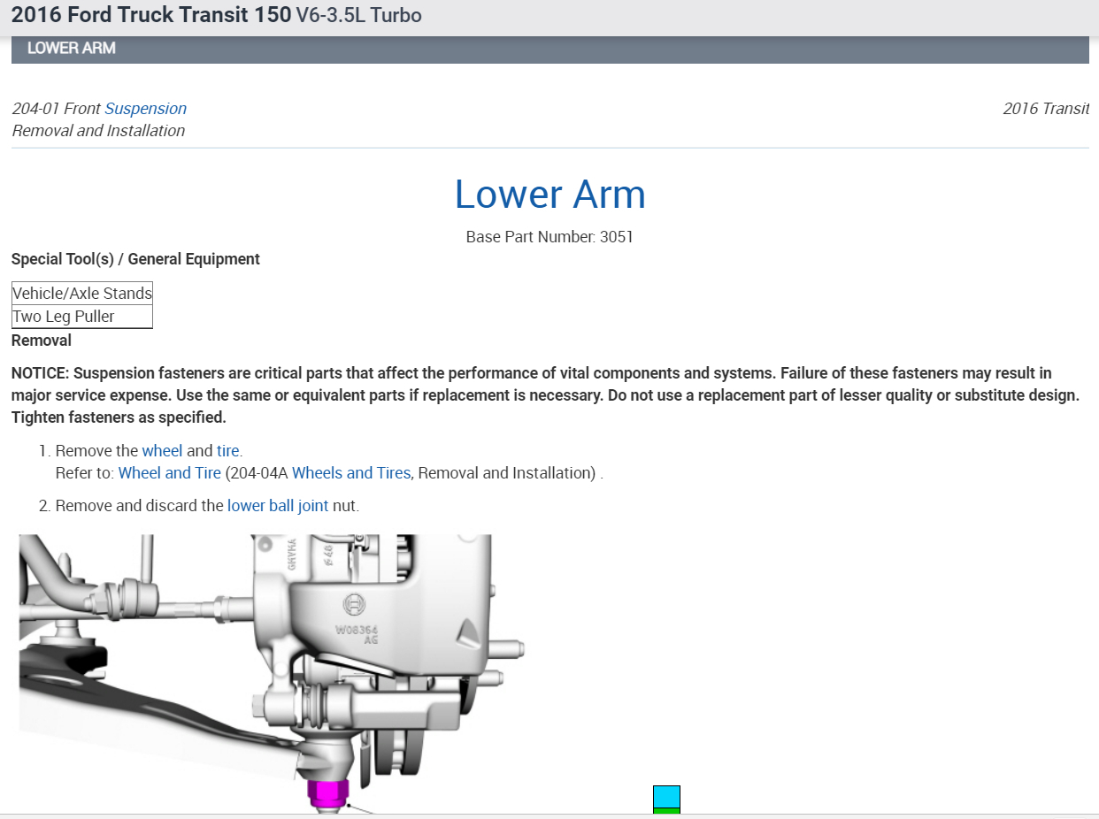

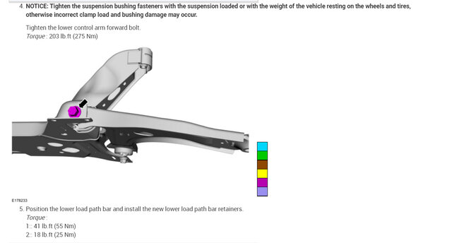

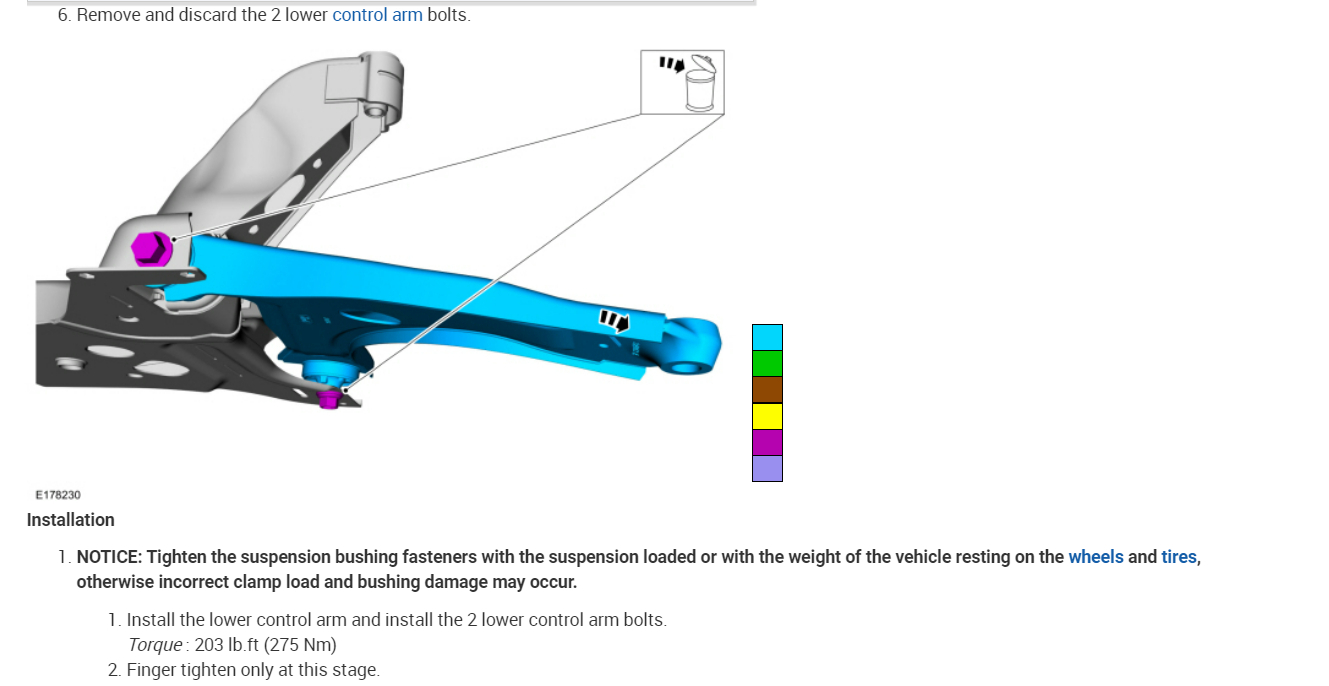

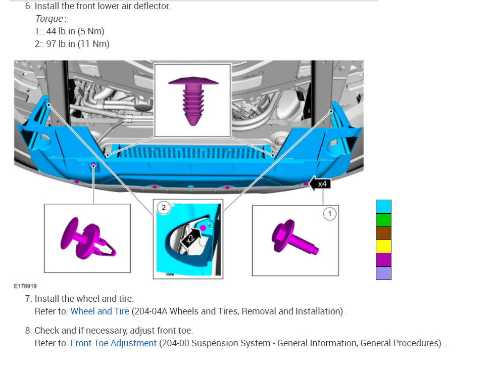

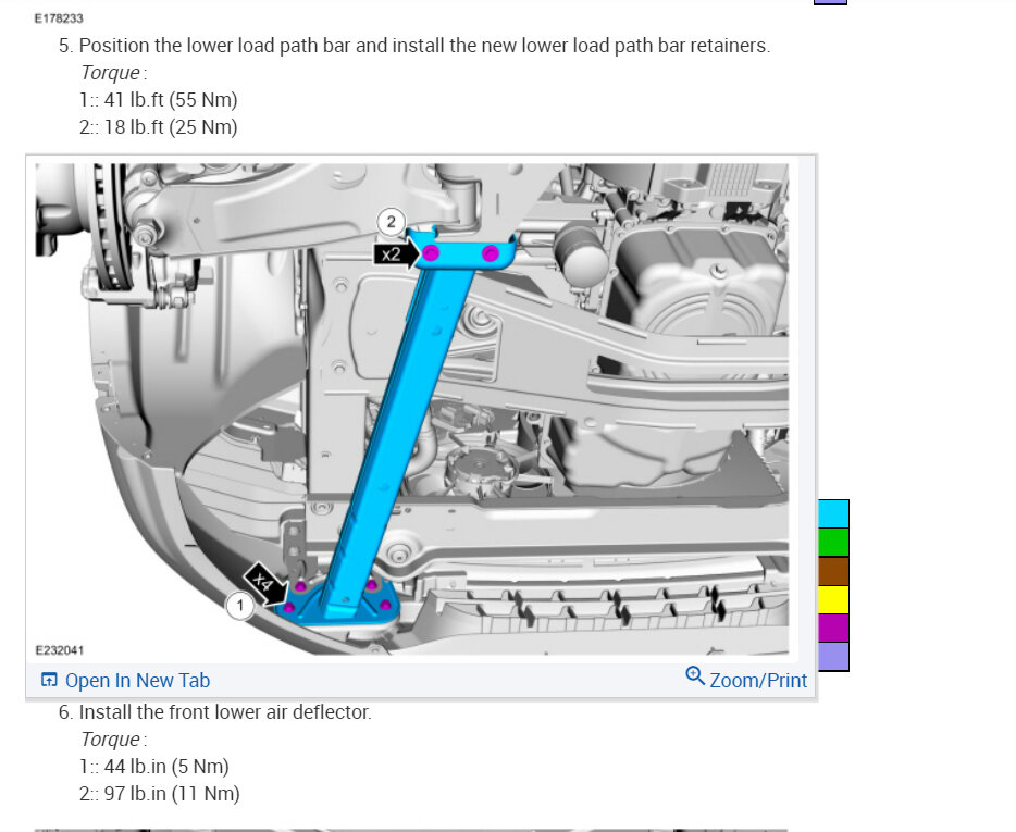

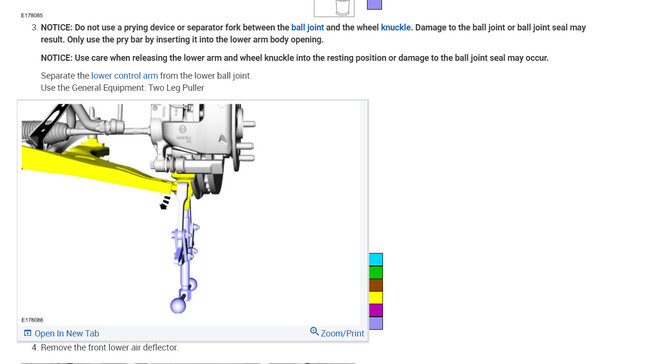

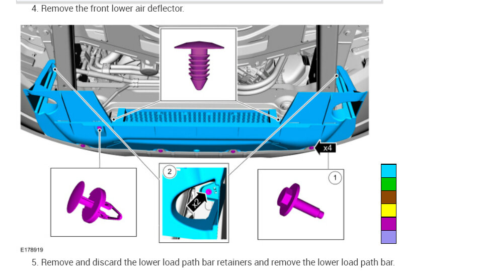

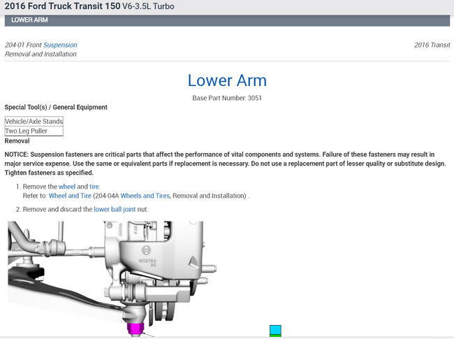

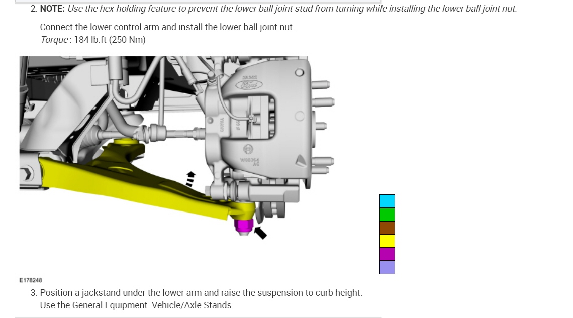

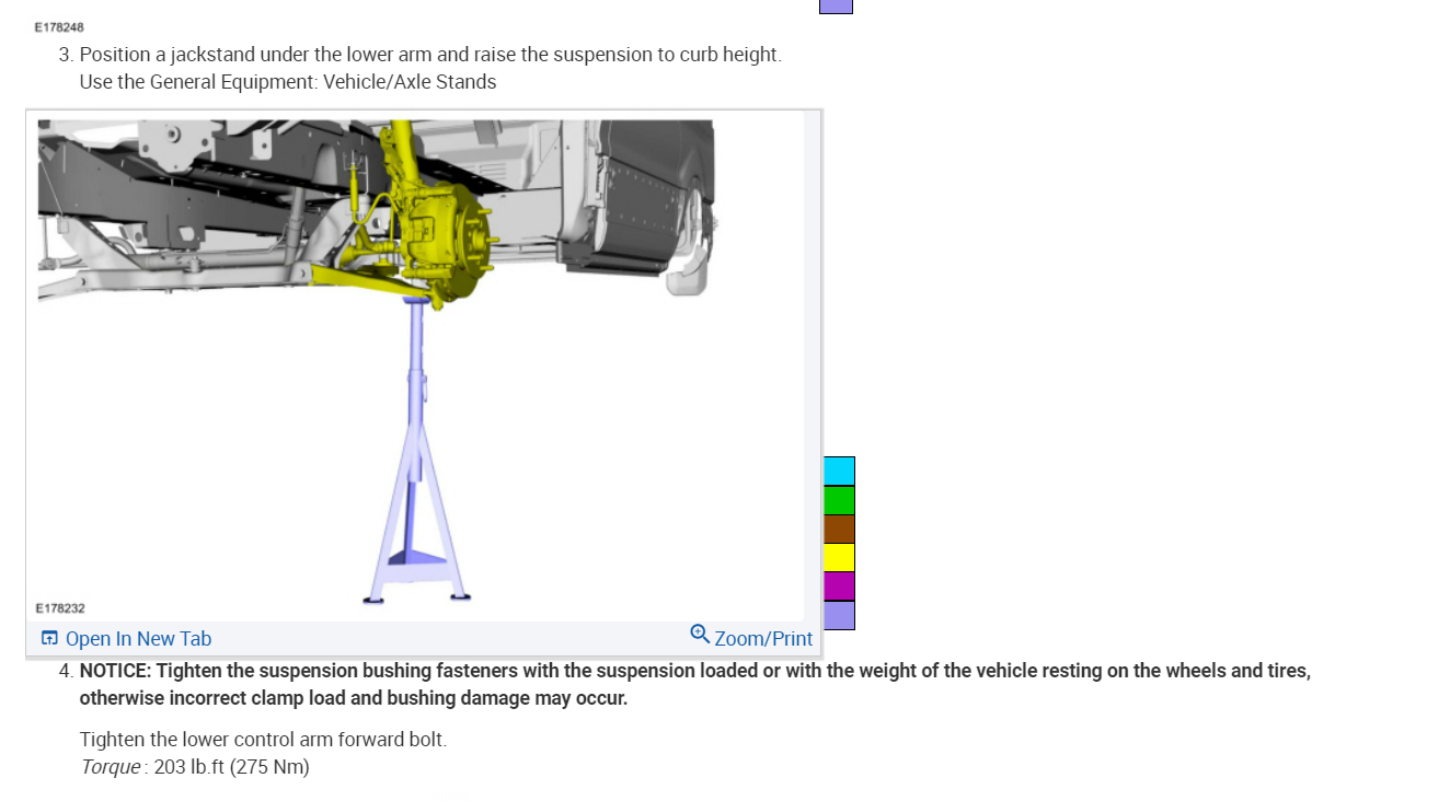

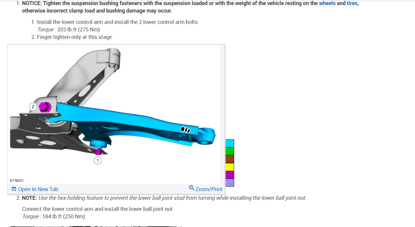

Yes, the bushings should not go out that fast but there are two arms on the front of the vehicle so did they both get fixed? Are they both bad? Here is how the job is done in case you want to see the work that was done or needs to be done. Check out the images (below). Please let us know what happens.
