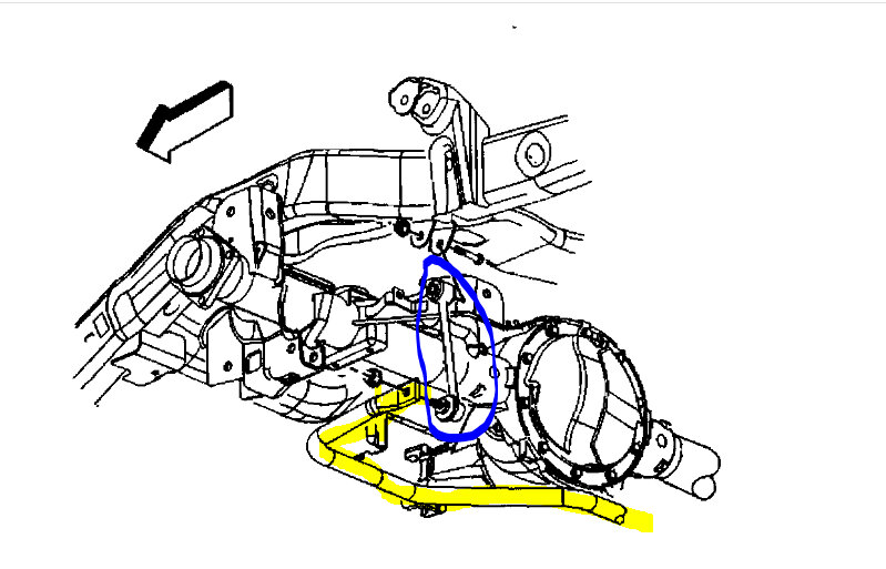

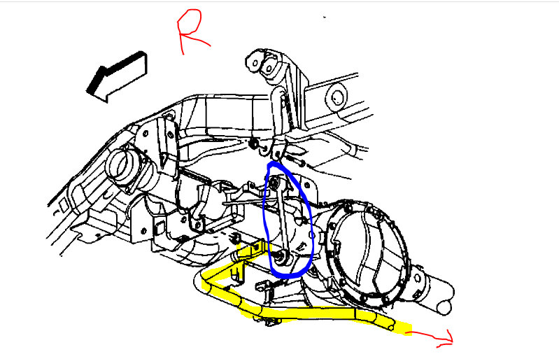

So, I’ve changed the front suspension and the shocks, but my truck keeps on swinging side by side when driving through a bump or going up speed really trying to fix this problem.
Feb 12, 2024 at 4:27 AM
  • 110,244 POSTS

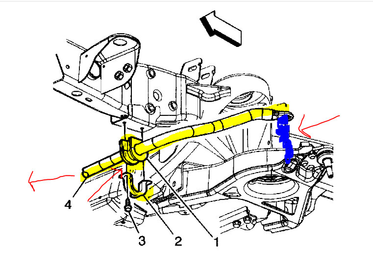

Have you checked to make sure there are no issues with the sway bar bushings (front and rear) and the stabilizer links?
I attached two pics below. Pic 1 shows the front and pic 2 is the rear. Check those things and let me know what you find. Additionally, let me know if you have checked the steering components as well.
See pics below. Note: Sorry about the pics. The last two are correct.
