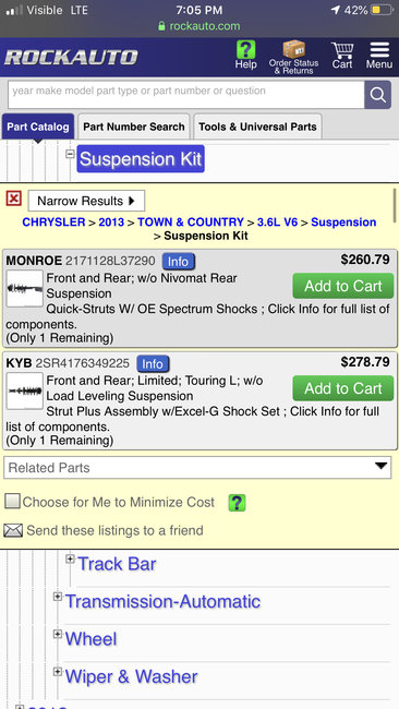

Wondering how to know which suspension kit to order
18 MILES • 3.6L • V6 • 2WD • AUTOMATIC
JACOBR97
  • 8 POSTS
Hello, I am wondering how I know which suspension kit to order off of rock auto for my van listed above. one says without Nivomat suspension don’t know what that is and the other says without load leveling suspension. not sure if my car has any of that. which is why I am asking this question.

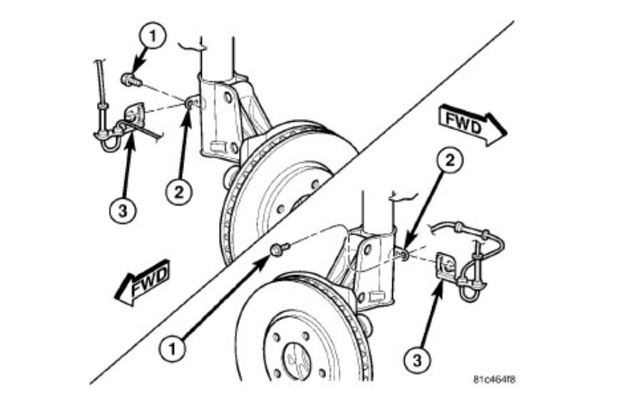

NOTE:
It is important to note that left and right side wheel speed sensor routing brackets (3) mount opposite each other on the strut making it necessary to install the left side mounting screw from the rear and right side mounting screw from the front.
Remove screw (1) fastening wheel speed sensor routing bracket (3) to mounting flange (2) on strut.

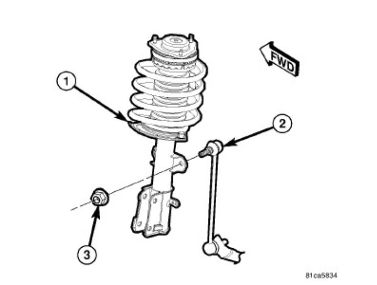

CAUTION:
When removing nut (3) from stud of stabilizer bar link (2), do not allow stud to rotate in it's socket. Hold stud from rotating by placing an open-end wrench on flat surface machined into stud.
Remove stabilizer bar link (2) from bracket on strut assembly (1). To do so, place an open-end wrench on flat surface machined into link's mounting stud, then remove nut (3) while holding wrench in place. Push stud out of bracket.

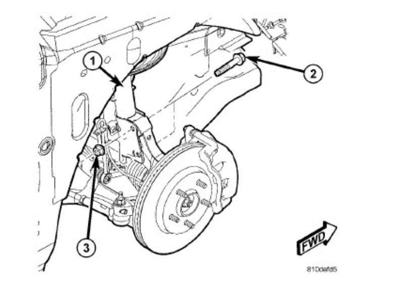

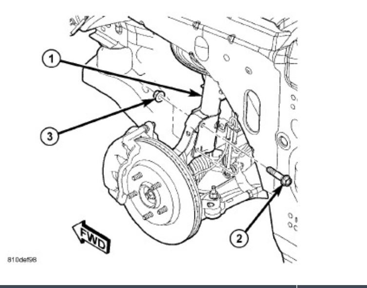

The strut assembly-to-knuckle attaching bolts are serrated and must not be turned during removal. Proper removal is required. Refer to the following steps for the correct method.
If servicing left strut:
While holding bolt heads stationary, remove two nuts (3) from bolts (2) attaching strut (1) to knuckle.
Remove two bolts (2) attaching strut (1) to knuckle using a pin punch.
If servicing right strut:

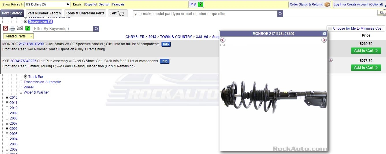

Thanks. so the one in picture will work for my van and no, no tow package.
Jan 9, 2020 at 10:39 AM
Correct.
