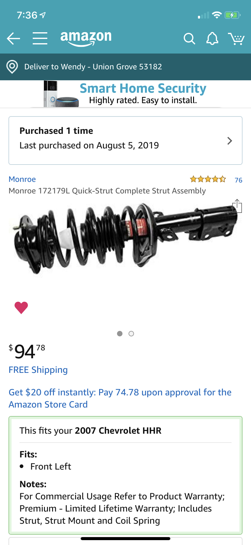

I had the control arm/ball joint and tie rod end replaced on the driver side. I just had the struts replaced last week. I know the roads are bad, but it doesn’t seem to make a difference when going over even the smallest cracks/divots in the road. Should I have also replaced the stabilizer bars? There still feels like a bounce when going over the cracks/divots like it was before changing the struts. I did not change the shocks on the back yet, but the bounce is in the front.

What kind of struts did you use to replace them? What brand?
That makes a big difference. The cheaper ones do not stiffen up the suspension that much.

Monroe.
Aug 25, 2019 at 5:35 AM
You got the best.

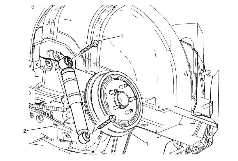

If the rear shocks are worn, it will joust the car as well. I would replace the rear shocks and see if it is any better.

Okay, I’ll do that next. I guess our roads are just that bad!! Thank you!!
