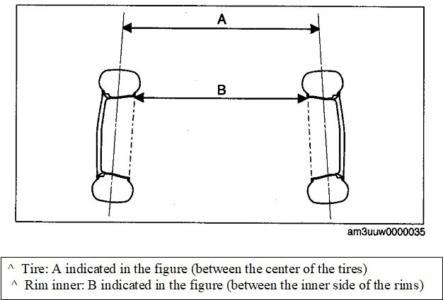

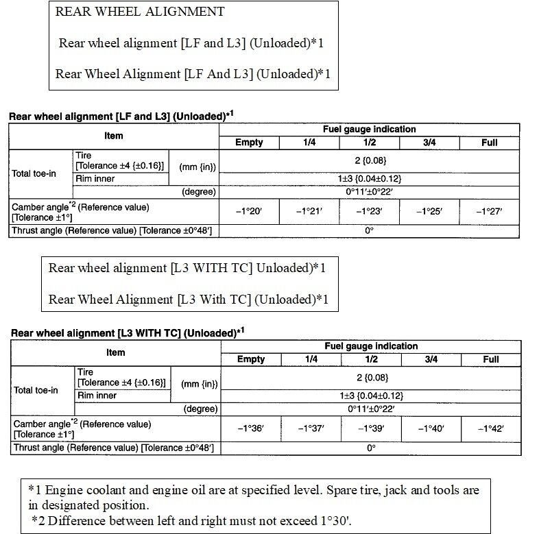

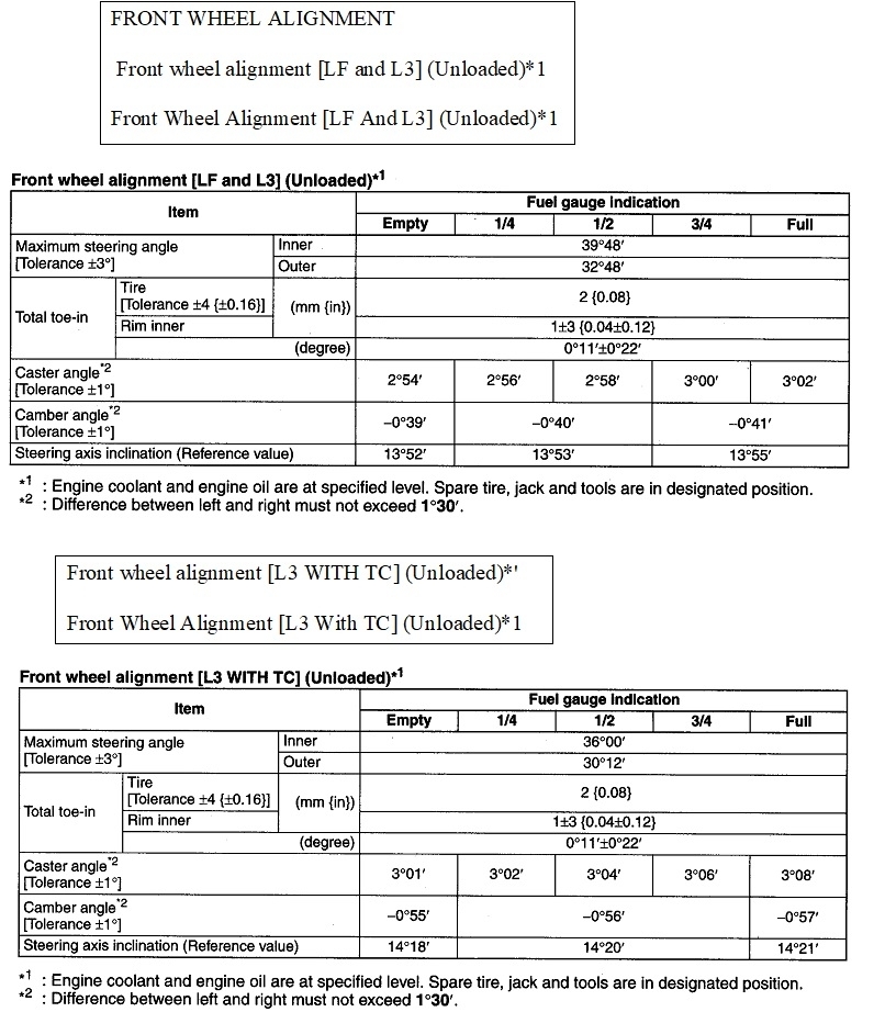

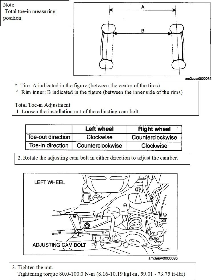

Normally alignment specs are pretty easy to read, but Mazda made it really complicated, as shown in these drawings. If you get a printout of your alignment, and post the numbers for "caster", "camber", and "toe" for each wheel, I can interpret them for you and compare them to what the specs call for.
