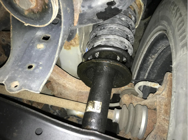

My car bouncing in front when missed the speed breakers or hit the potholes.
Aug 7, 2022 at 3:36 AM
BORIS K
  • 836 POSTS
It sounds like you might have a problem with the front shock absorbers.
Worn shock absorbers will cause the vehicle to bounce a lot as the damping effort is no longer working.
An easy check is to have a look at the shock absorber from underneath and see if there is any visible oil leaking.
See image below.
