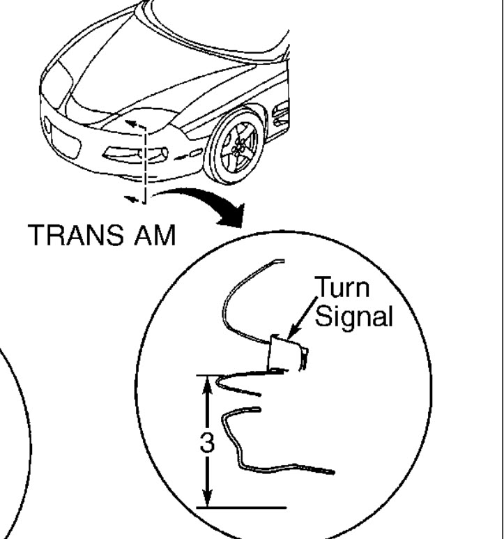

I recently purchased this car. It seems to have problems bottoming out or dragging underneath when hitting small dips or bumps. I have a 1999 Z28 Camaro and did not have this issue. Any ideas or suggestions on how to fix this? I have replaced shocks and struts all the way around the vehicle and still have this problem. Wonder if this is a common issue with this model vehicle since it sits so low to the ground?

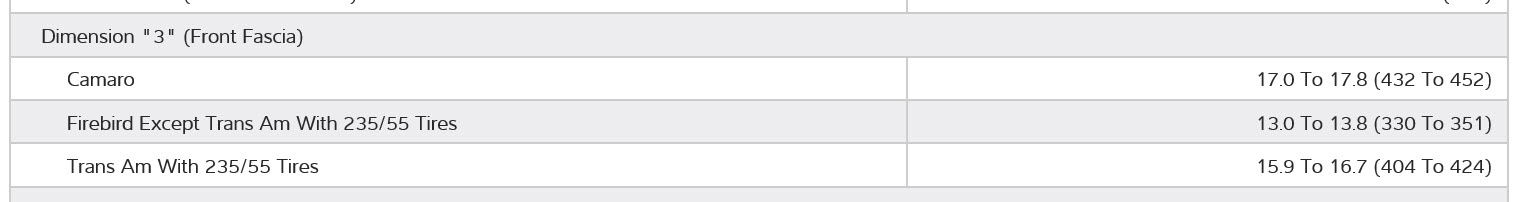

has the car been lowered? it may have prior to you getting it and nothing was said about it. bounce the suspension three times by hand on front end then take measurement in pictures. the Trans Am will sit lower than the Camaro.

Hi guys. You mentioned the struts and shocks. Those have nothing to do with ride height. It's sagged coil springs that must be replaced. That's where measuring ride height is important. Along with that, even though the numbers on an alignment computer might show everything is in perfect alignment, that is only for a car that is sitting still on the hoist. For a car in motion, the suspension geometry must be correct, and for that to be true, ride height must be correct. A conscientious alignment specialist will not align a car that is sitting too low because there IS going to be accelerated tire wear and poor handling. Only new springs will solve that. Many mechanics save their customers money today by installing new struts with the new springs already installed. Parts cost more but installation time is cut a lot.
