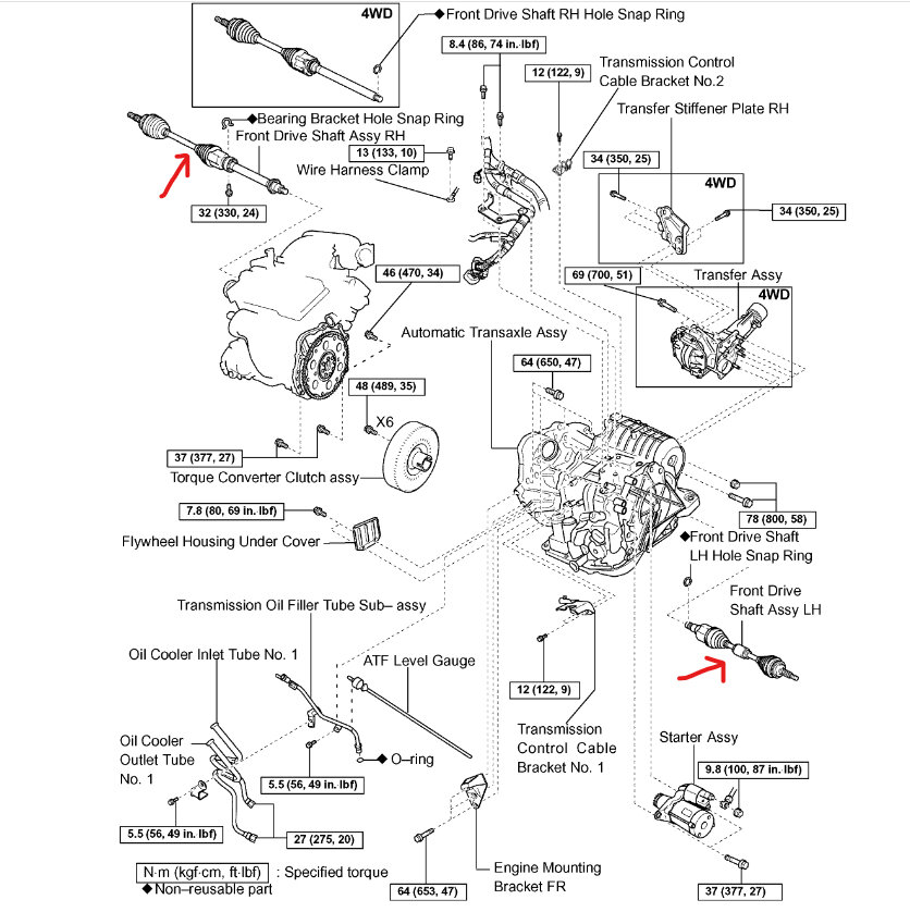

When I'm speeding up, between 35-60mph, the front-end wobbles. What might be the issue? I've already had the alignment and tire balance checked.

Yep, this happens when the CV axles wear out, I would replace both of them. Here is a generic guide to help you step by step with instructions in the diagrams below to show you how on your car.
https://www.2carpros.com/articles/replace-cv-axle
Please go over this guide as well:
https://www.2carpros.com/articles/symptoms-of-a-bad-cv-axle-joint
Check out the images (below). Let us know what you find.

Would someone be able to tell me how to drain the grease from my front axle so I can get the axle and grease recycled?
Jul 16, 2025 at 5:11 AM (Merged)
  • 55,447 POSTS
Changing the grease will not help, the CV axles will need to be replaced to fix this problem sorry.
