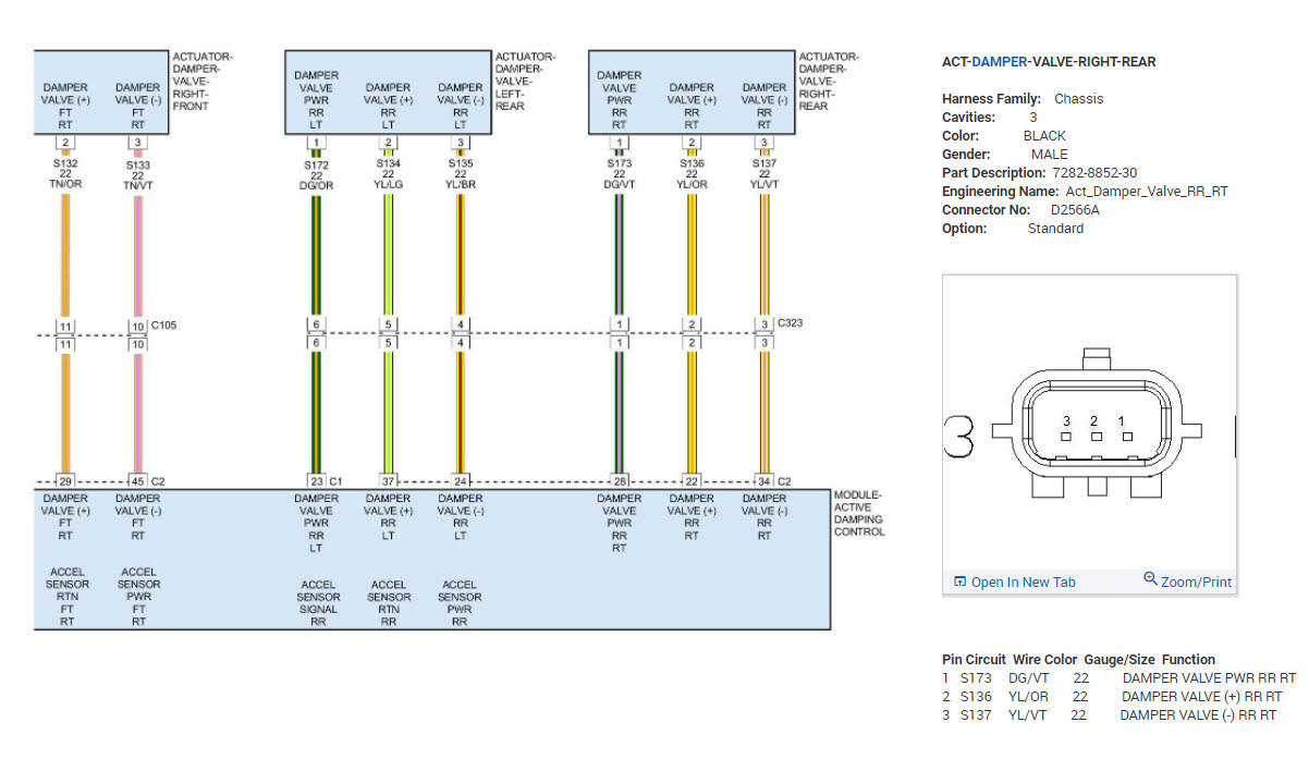

I'm looking to figure out the wiring diagram for 2012 srt8 charger rear right active dampening suspension 05181576ac the one I'm looking to find the diagram meaning which of the 3 wires belong to what spot in the clip and what the function of each wire is because
I have a Hellcat shock for my car 05181908ab.
The clip was broken and I want to see if I can use the harness wire clip (not sure how to refer to it) from the 05181908ab I have the diagram which tells me the function of the 3 wires for the Hellcat shock.

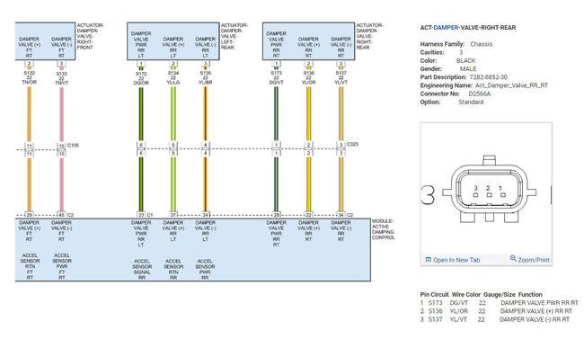

You'll have one constant power wire, and a positive and negative that control the jounce and rebound of the shock by means of the controller by opening and closing internal valving. I've attached an illustrated diagram with the connector pinout. Hope this helps.

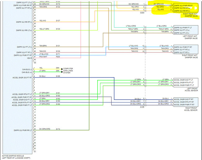

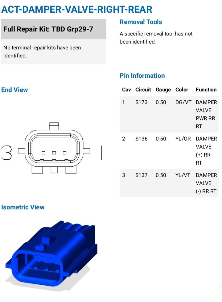

So the diagram I have isn't as in depth like that for the one I found I'll attach it. do you think you could send me a better one like the previous attached? thank you by the way!

JMALLIE224
Well, in depth I meant like it isn't as clear with what pin is which number.

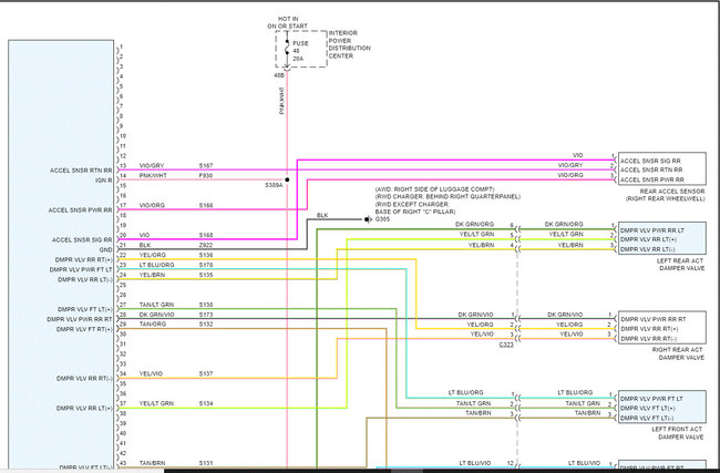

I attached the entire wiring schematic below for the electronic suspension. I highlighted the right rear.
Note that the wires are numbered. Correlate those numbers with the connector pic you have above.
