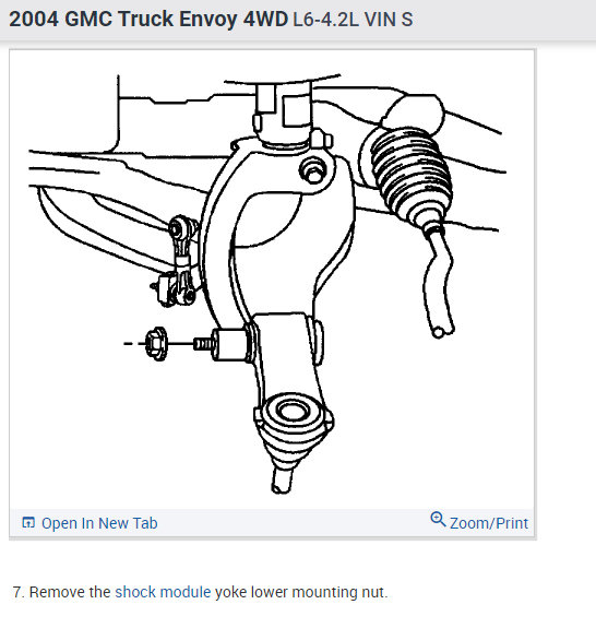

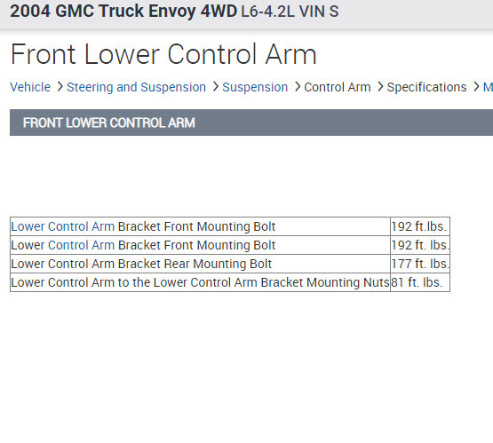

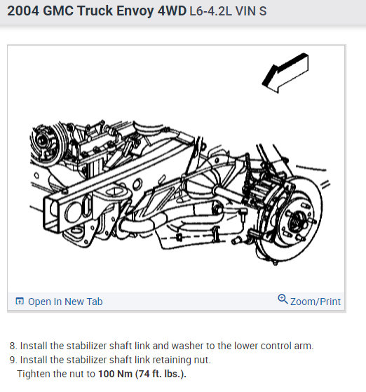

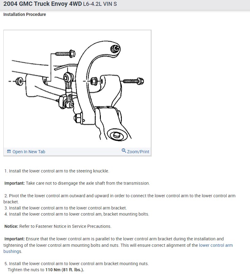

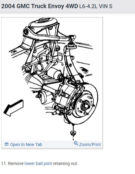

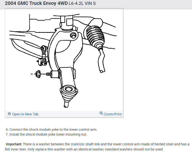

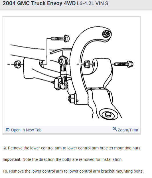

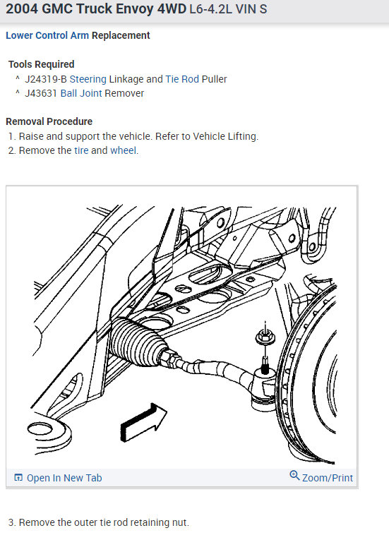

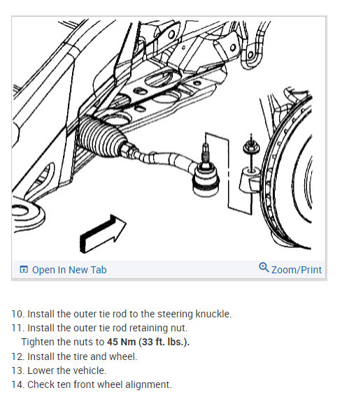

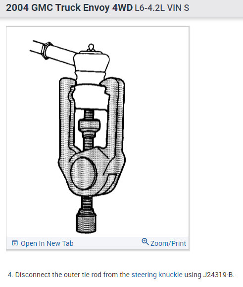

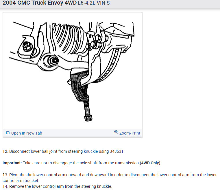

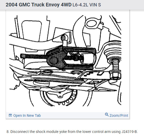

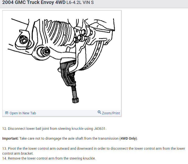

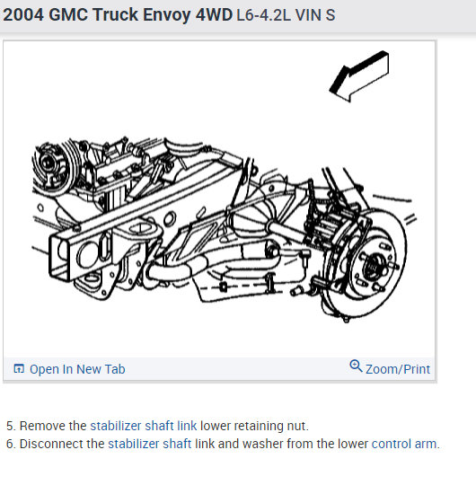

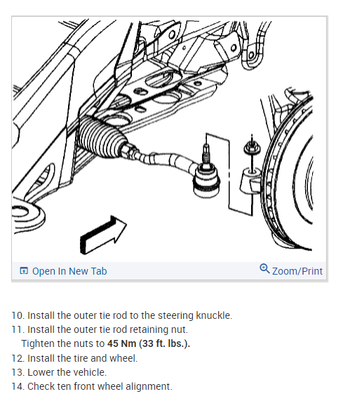

I probably need to change my lower control arm or if the lower ball joint is still in good condition, I will change just the bushings. Would you have the torque specs for this task? I want to make sure I do everything to specs. Thanks ahead of time.
Sep 19, 2021 at 8:13 PM
SQM
  • 6,383 POSTS
I have included the replacement diagrams below. It has all the necessary torque specifications for your reference.
https://www.2carpros.com/articles/lower-control-arm-bushing-replacement
