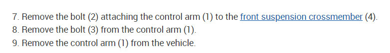

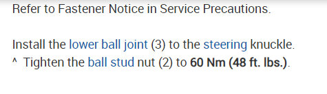

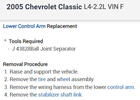

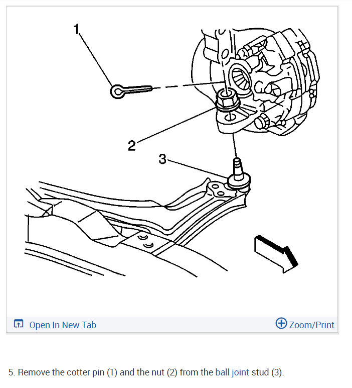

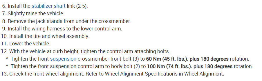

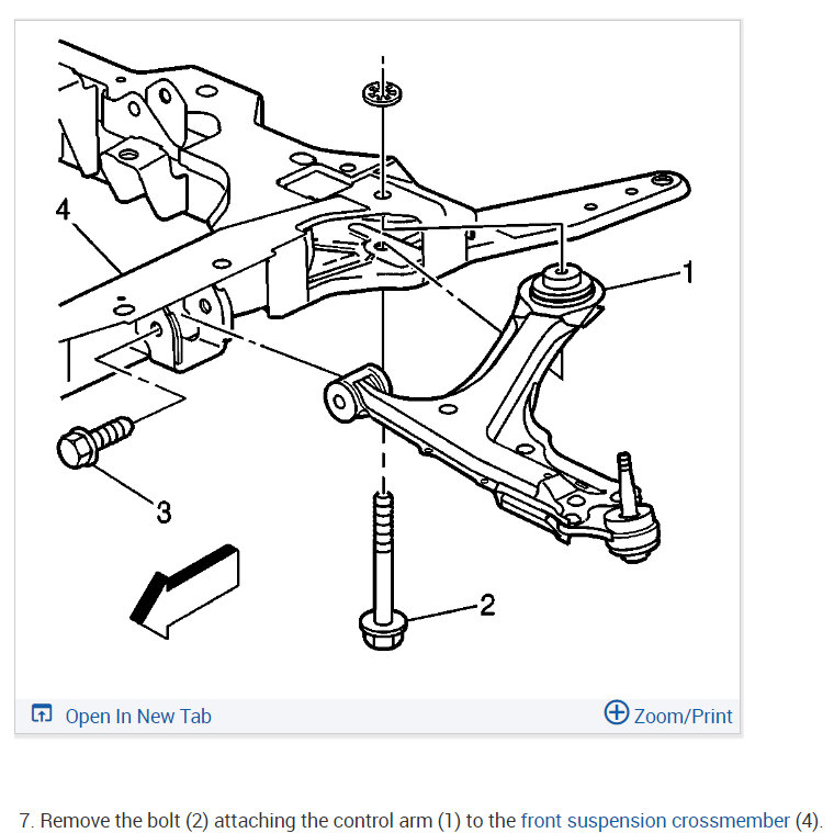

How to replace lower control arms?
82,000 MILES • 2.2L • 4 CYL • 2WD
LOUIS GRANT
  • 8 POSTS
Sep 30, 2024 at 11:51 AM
  • 55,694 POSTS

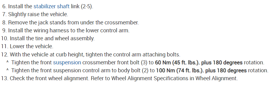

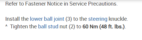

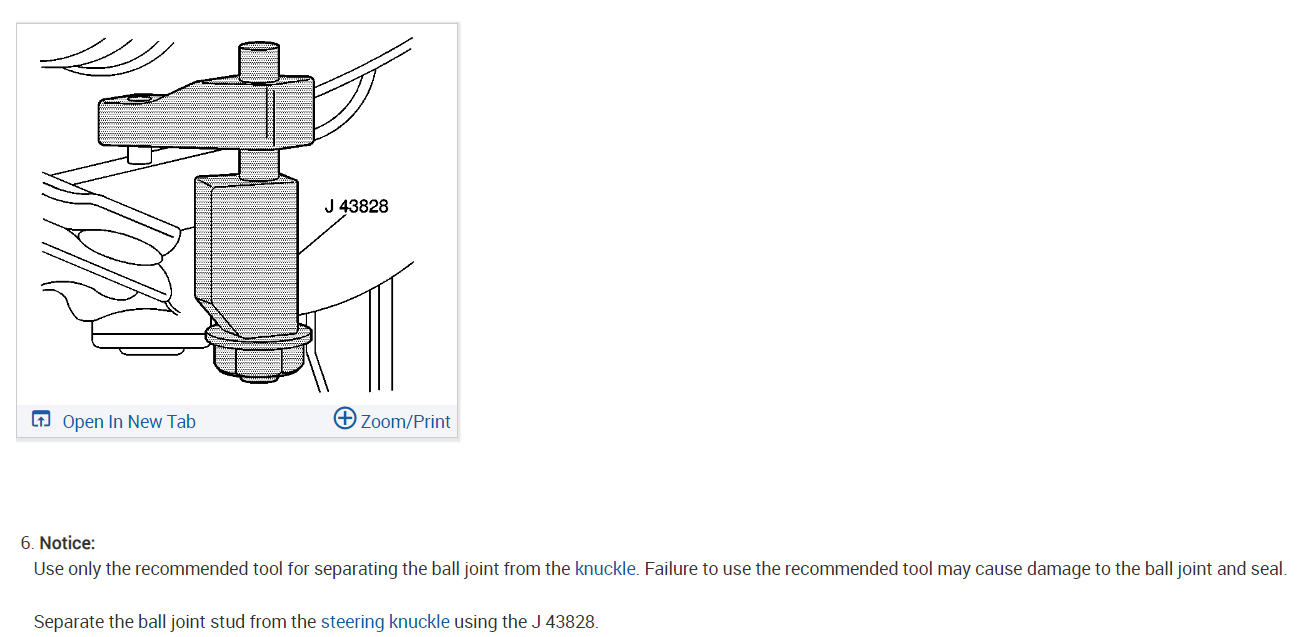

Hi Louis,
Sure, here are the instructions on how to replace the lower control arms on a 2005 CHEVROLET CLASSIC. Check out the images (below). Let us know if you need anything else.
