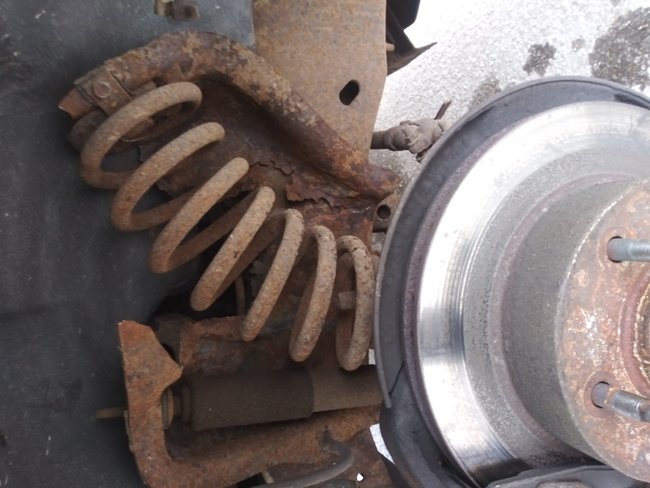

coil spring mount, is it replaceable?
1994 FORD F-150
310,000 MILES • 5.0L • V8 • 2WD • MANUAL
MICHAELCROWLEY629
Trying to determine what to call this broken or rusted out part is? It holds the shock and spring in place. Is it replaceable?
May 19, 2021 at 10:42 AM
NICKOLAOSF
  • 69 POSTS
Hi Michaelcrowley629,

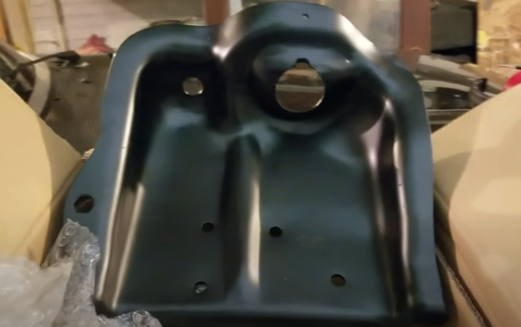

It look like you have rust problems, by the looks of just that side you will need to inspect all suspension part first and then visit the nearest used part lot and it would be a good idea to get complete front end (strut tower is looking what you need but remember do to rust the other side will go as well). I am glad to help you, if there is anything else we can help you with please contact us again. Thank you for choosing 2CarPros.
Cheers, Nick
Check the image below.
