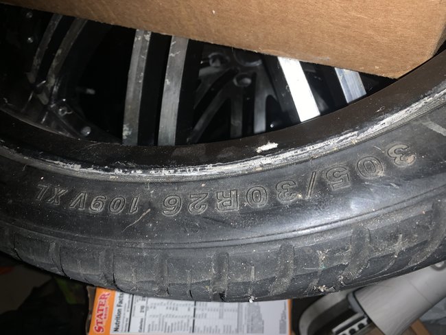

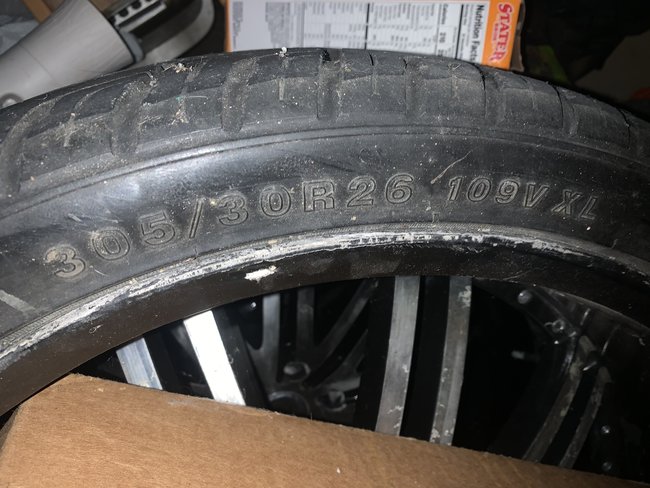

Yea, I’ll put a picture.
Feb 22, 2021 at 5:19 PM
ALEXANDER ZAMARRIPA
  • 7 POSTS
Is that fine?

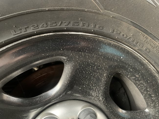

Here’s the stock one:

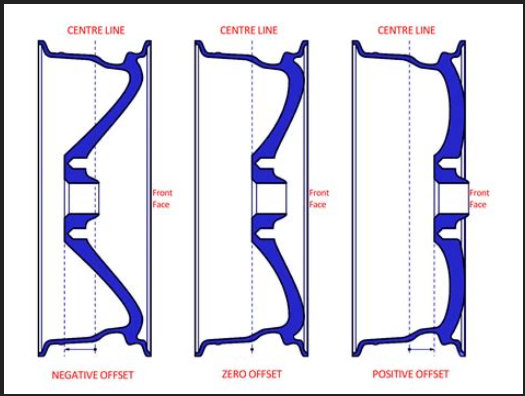

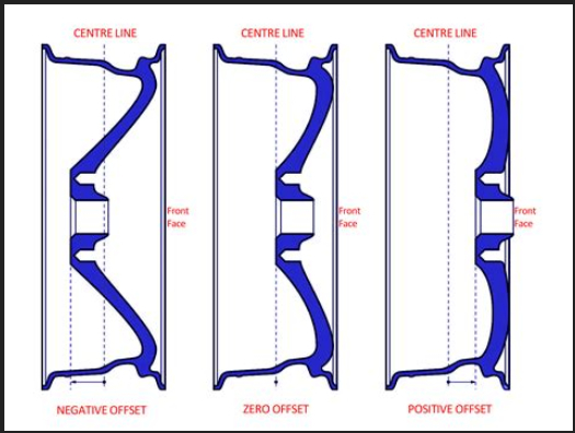

Okay, two things. First, since you already have the wheels and tires, are you sure the bolt pattern is correct and the correct offset? I attached a diagram below that will help with this.

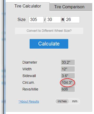

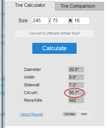

Second, the difference in circumference may be a little too much to leave it as stock. The difference is about 8 and a half inches. This means it is 4 inches on both sides.
So I would start with bolting them on the truck and checking the clearance in the wheel well area. If the tire is close to the fender liner then you are going to have to lift the truck. Then turn the wheel lock to lock and see if the tire touches the fender or frame rail. If it does then you are going to have to use a spacer as well.

The 26’ rims were on the truck before but they were removed because one of them needed a new tire. But we just put back the stock rims because we didn’t want to damage the suspension after what that guy told me. Sorry I didn’t say this before.
Feb 23, 2021 at 8:10 PM
Wheels and tires will not damage your suspension. I am not sure what they are referring too but even if they are rubbing then they will really only hurt the wheel/tire.
So if they were on before and did not rub then I would say they are fine.
