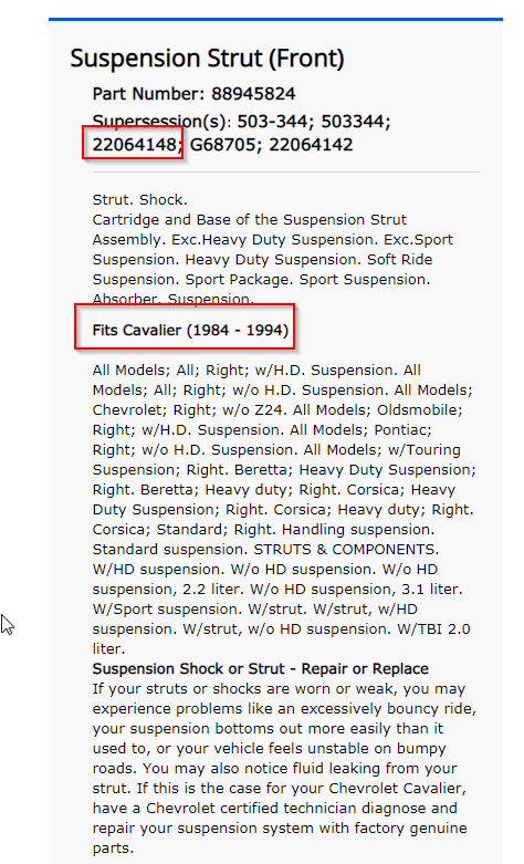

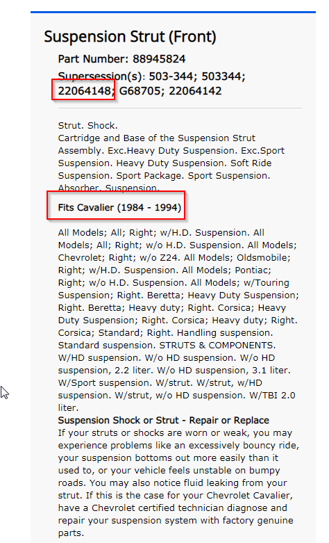

I’m having issues finding loaded front struts for the vehicle listed above (wagon). Will the struts off of a 1991 Cavalier fit the 1994? Thank you in advance.
Jan 24, 2021 at 11:50 PM
It looks like from common GM parts website that this part number for the right strut assembly 22064142, fits from 1984-1994. So it appears that will work.

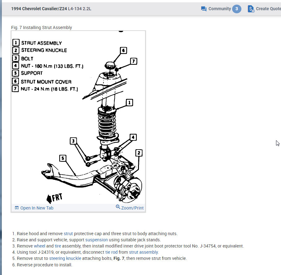

Please see below for the part information on this plus the repair process from the manual.
Let us know if you have other questions.
