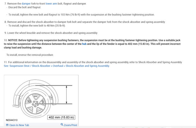

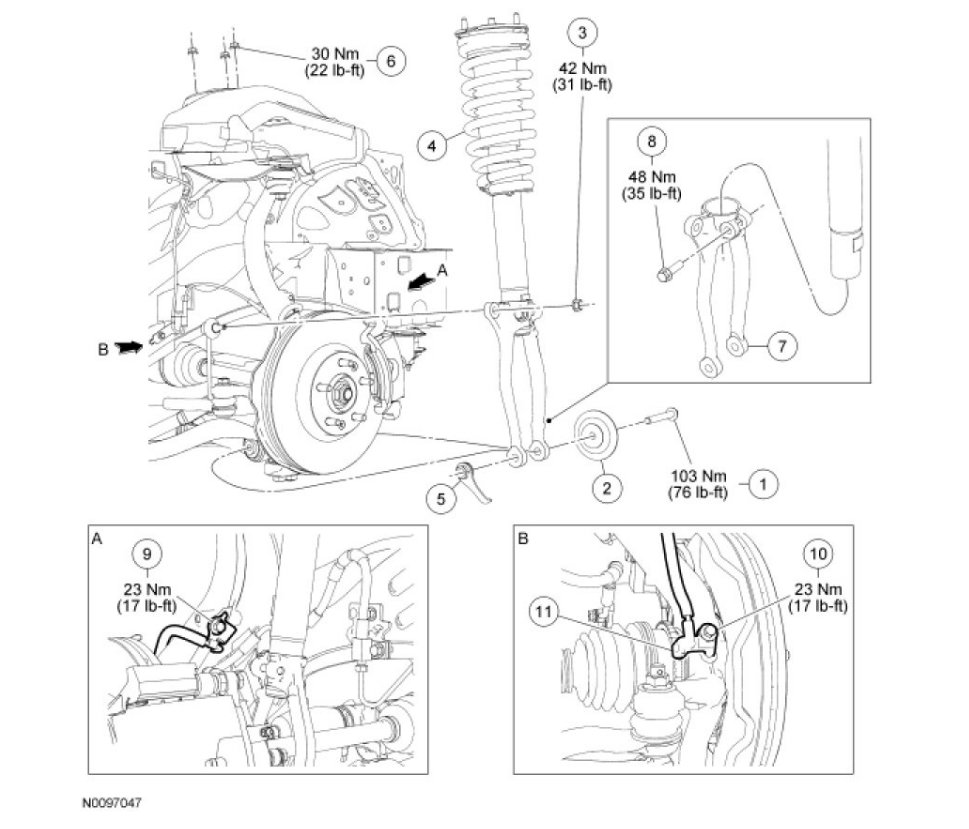

Most of the time it will be the struts. To be sure can you upload a short video of the noise here in your response? Here are two guides to help you with the instructions on how to change the struts out for your car in the diagrams below:
https://www.2carpros.com/articles/popping-noise
and
https://www.2carpros.com/articles/how-to-replace-a-suspension-strut-and-spring

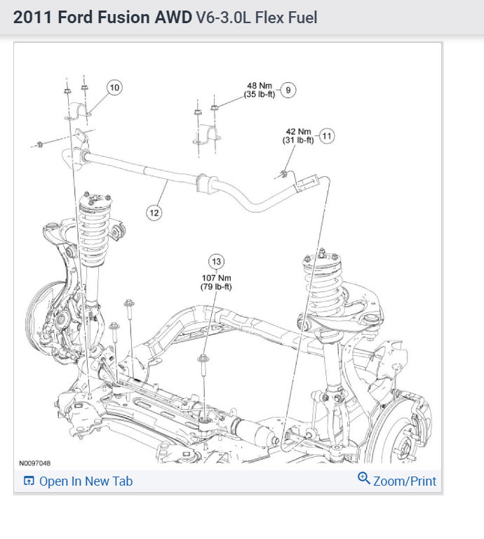

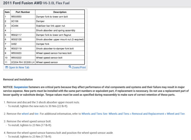

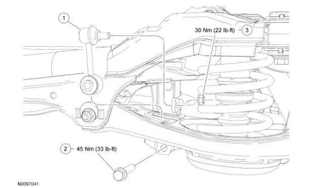

I was going to suggest the sway bar links next, this is the tough part with noises over the internet, that's why the video helps. Here is how you can replace the links and mount bushings. Also, check the guide in the above post. Check out the diagrams (below). Let us know what happens and please upload pictures or videos of the problem.
