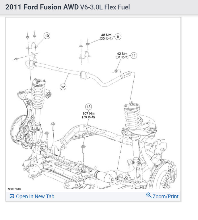

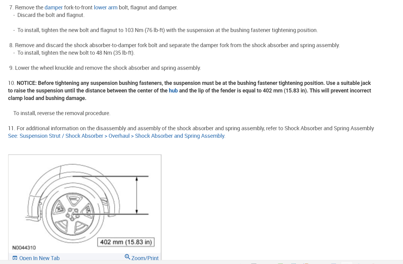

Have a suspension noise going on, front end crunching/creaking kind of noise. Started last summer, went away during winter, but back again. At first only kind of did it while turning at parking lot speeds, now does it nonstop turning or not at parking lot speeds, also at 40-50 I can kind of hear it now too. weird because it only seems to do it when hot out. Also seems only when the car is driving, kind of why it's been hard for me to figure it out. I don't have much knowledge on suspension and I don't trust shops around my area as they've lied multiple times previously. I can't afford that again. Any help figuring this out would be much appreciated.

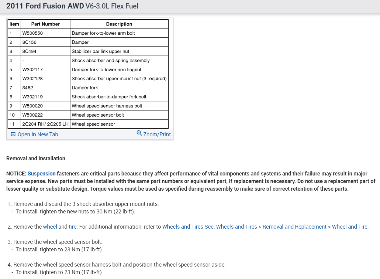

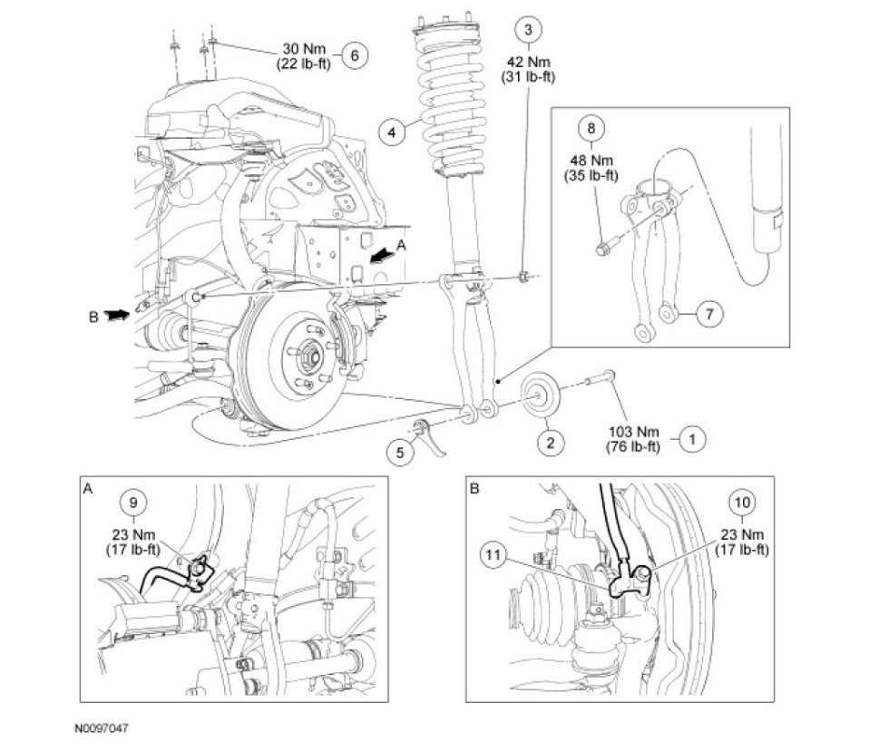

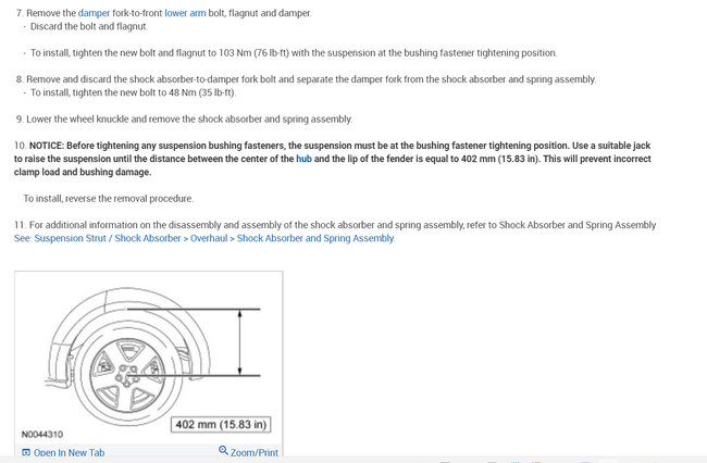

Most of the time it will be the struts. To be sure can you upload a short video of the noise here in your response? Here are two guides to help you with the instructions on how to change the struts out for your car in the diagrams below:
https://www.2carpros.com/articles/popping-noise
and
https://www.2carpros.com/articles/how-to-replace-a-suspension-strut-and-spring

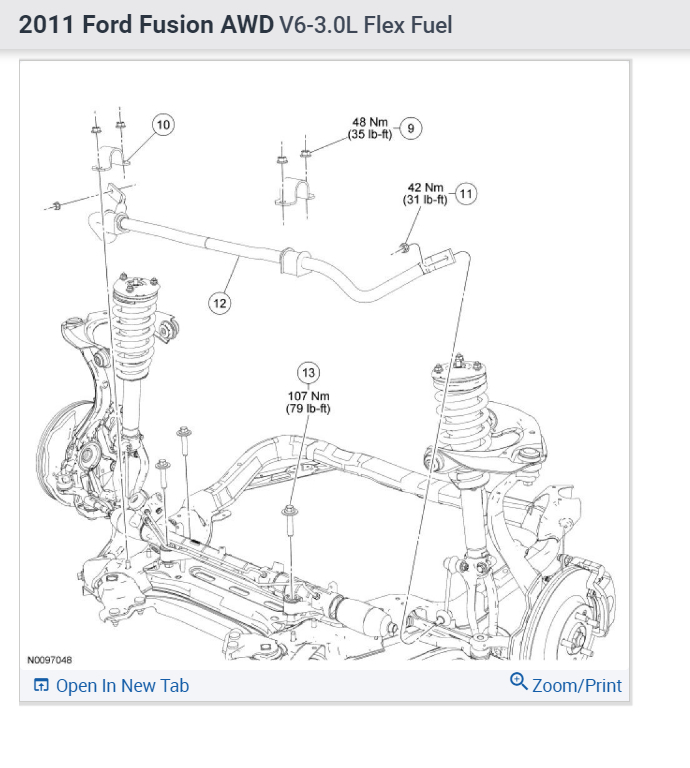

Hey, thanks for replying. Couple questions. If it were to be the strut, would I be able to hear the noise when pushing down on front end? Or when the car isn't moving? It seems to only do it when the car is in motion (more parking lot speeds) and only when it's hotter outside. I can try and get a video tom, will take pics of suspension as well to see if anyone notices something off, would be on a cell phone though so may not be the best. I watched several videos on YouTube, none pinpoint exact, but one seemed more accurate to check, that was away bar link. Others mention bushings, I've tried spraying white lithium on what I can but still does it.

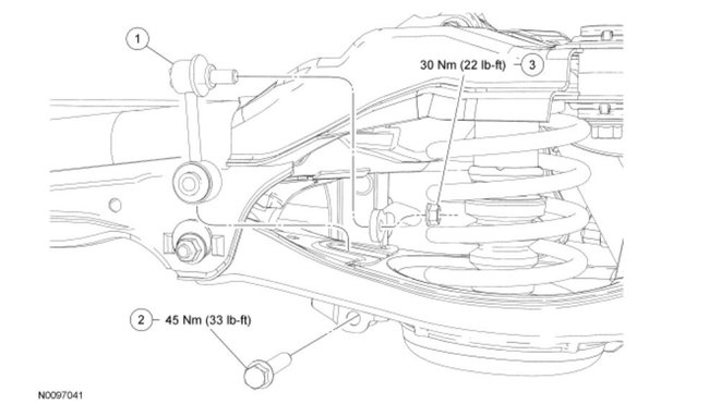

I was going to suggest the sway bar links next, this is the tough part with noises over the internet, that's why the video helps. Here is how you can replace the links and mount bushings. Also, check the guide in the above post. Check out the diagrams (below). Let us know what happens and please upload pictures or videos of the problem.
