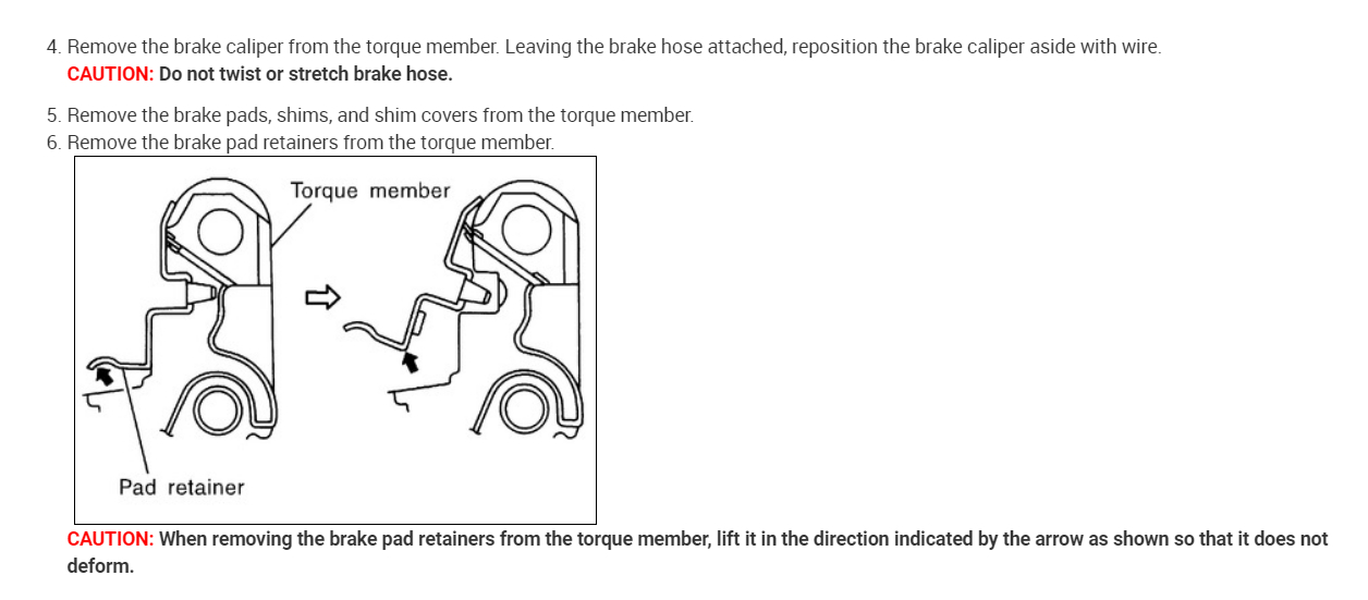

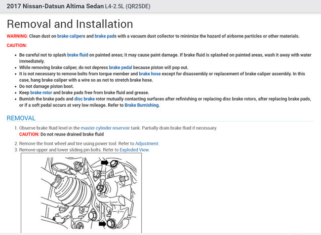

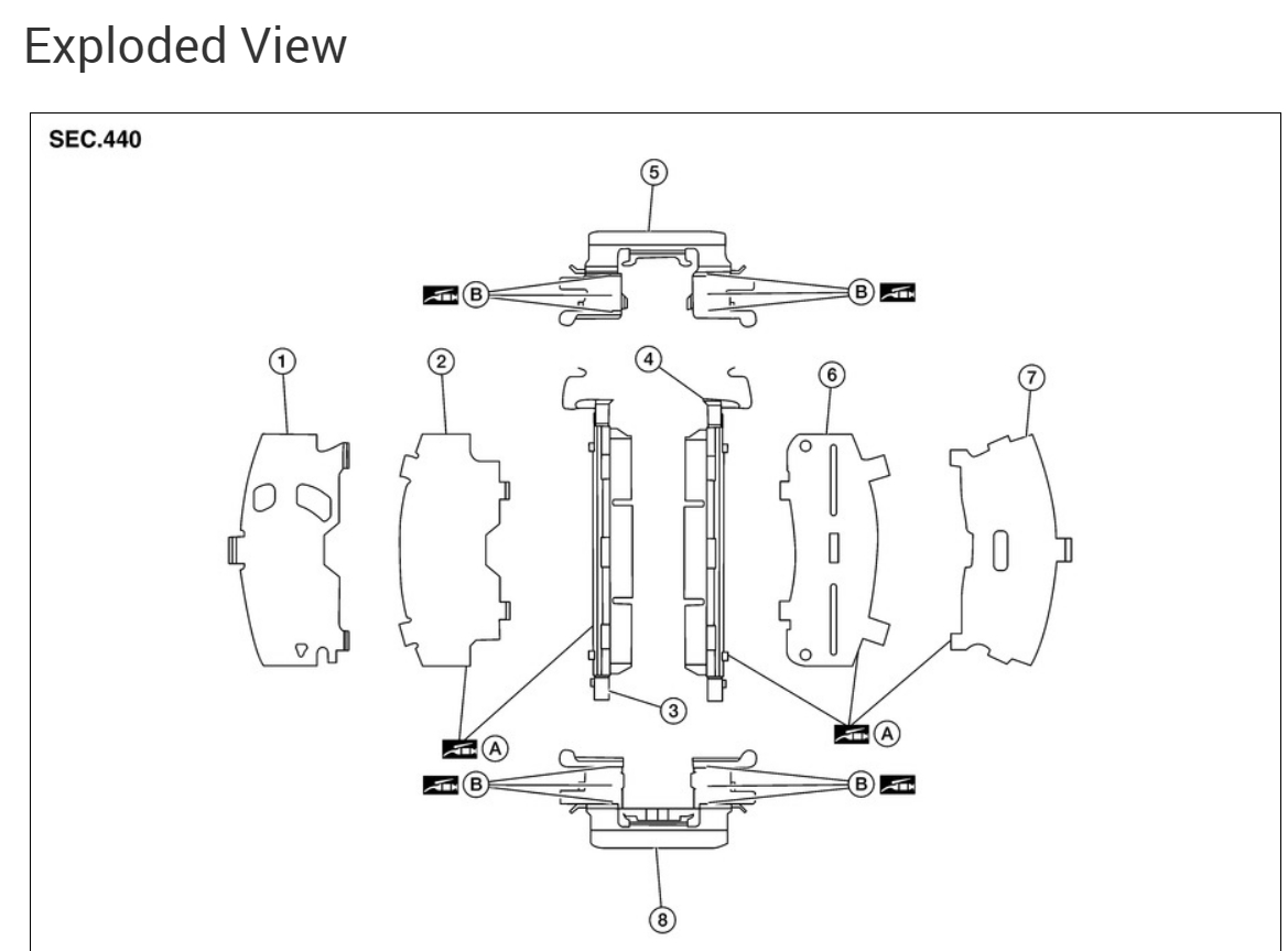

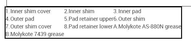

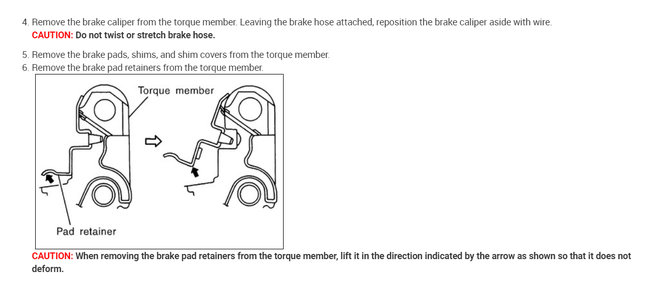

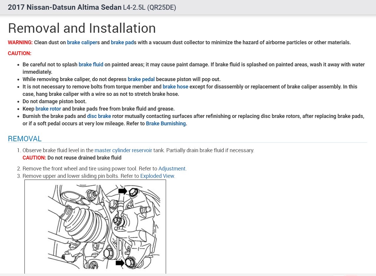

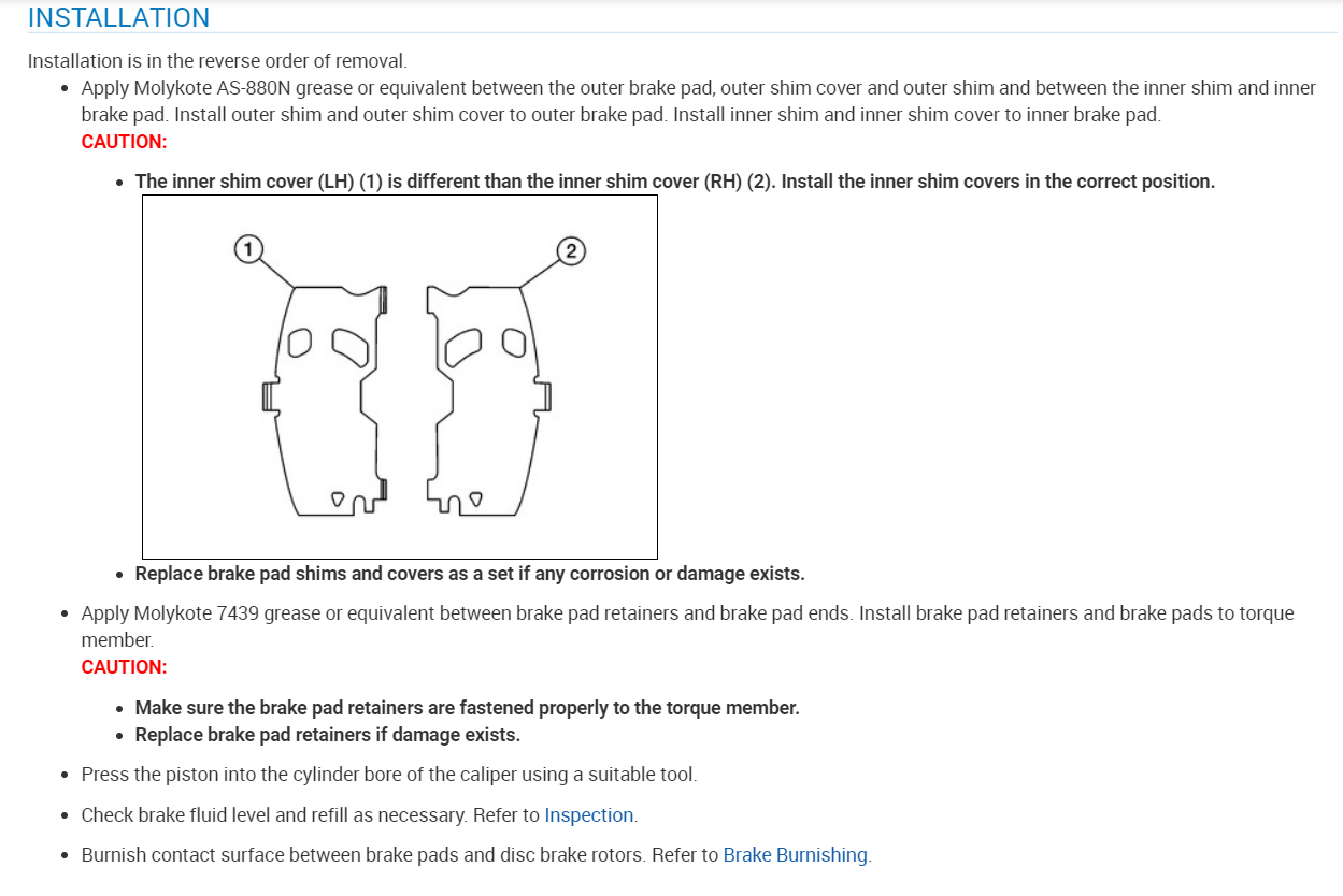

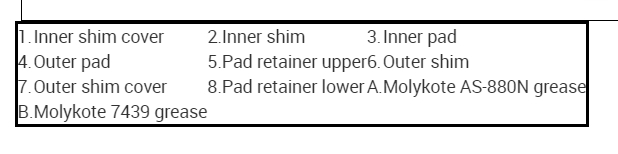

When the brake pads get low, they have a warning "screamer" that makes noise at slow speeds and when you hit the brakes, this can vary, I would remove the front wheels and inspect the brakes. I can tell for sure if you can please shoot a quick video with your phone. You can upload it here with your response. These guides and video, can help you lift the car safely and remove the front wheels and do the brakes if needed:
and
https://www.2carpros.com/articles/wheel-removal-and-re-installation
and
https://youtu.be/UoWFcNAo-YQ
