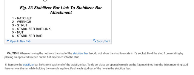

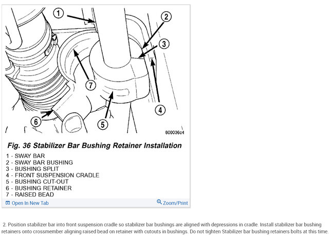

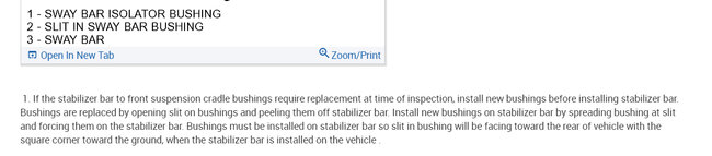

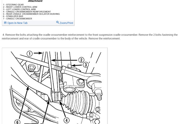

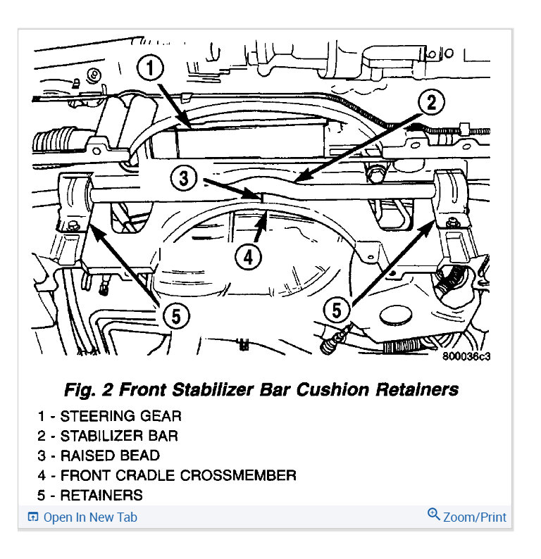

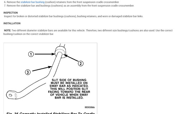

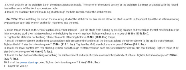

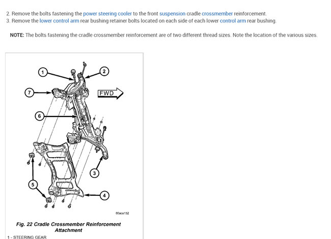

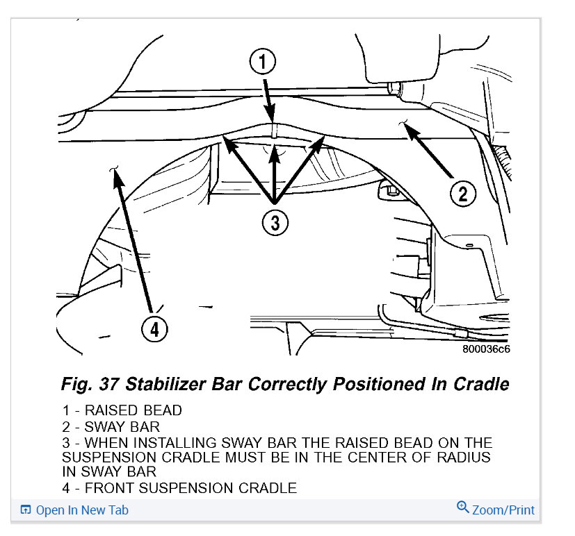

I have seen bent sway bars before yes, but if one jack it up one side at a time it will load the sway bar, if you can see the bar physically bent then there is no question. Here are instructions on how to replace it. Check out the images (below). Let us know what happens and please upload pictures or videos of the problem.
