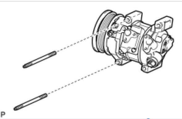

A/C is Warm. High and low side pressures are both 100psi. suspect it is the A/C compressor. I want to change the A/C compressor and need the exact factory service manual steps please. Also, the driver's side electric fan did not come on until it was tapped a little bit with a metal object. probably going to change that as well and need the steps.it is hard to see the clutch on the A/C compressor come on because it appears hidden within the pulley, but since I can't hear it come on, I suspect its not. I also suspect that the compressor is leaking internally causing the 100 psi readings on both manifold gauges and highly doubt it is a bad expansion valve. thoughts?

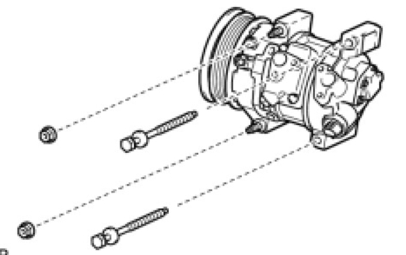

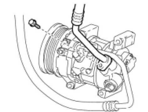

If you can't see if the clutch is engaging, I would not assume the compressor is bad. I would turn the system on and check for power at the light green wire to the compressor if you have power and the system is sitting at 100 PSI then the compressor is bad. Here is a guide to help you:
Please start a new thread for the fan motor replacement, we only handle one problem per thread, please post your new question here, you must be logged in.
Here is how to replace the A/C compressor and a video for the vacuum down and recharge.
https://www.youtube.com/watch?v=4EqdrBVb0sY
You must remove the two studs and the two bolts to get the compressor out FYI. Check out the images (below). Please upload pictures or videos in your response
