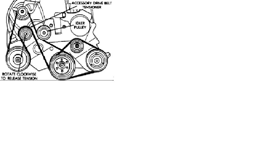

serpentine belt came off. how does it go back on?
Dec 12, 2016 at 3:16 AM
CARADIODOC
  • 34,403 POSTS

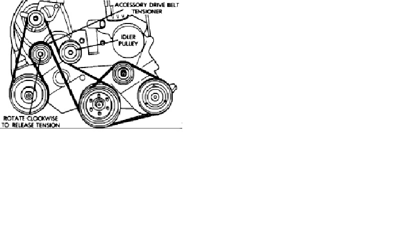

There is a diagram on the passenger side on the front of the plastic timing belt cover. The belt will look like an upside-down "V" when you are done. Check out the diagrams (Below). Please let us know if you need anything else to get the problem fixed.
