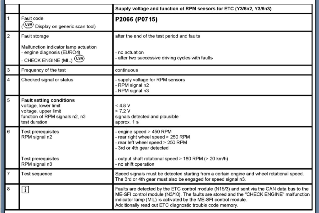

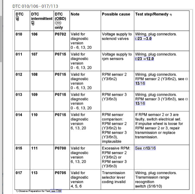

Hello, lately my car has been acting up. It will buck and surge when going very slow or taking off. Plus acceleration is poor when it happens. Also car will start shaking but only in drive. It doesn't happen all the time. The other issues I listed happens mostly with A/C on. Best comparison is to a new person driving stick when you don't give enough gas . I haven't checked plugs wires, coils or fuel pump. There aren't any codes except for a pending o2 sensor. The car went into limp mode 2 times in one month but only last few seconds. I replaced my 13 pin adapter and did new fluid. I pulled a p0715 code so I felt I'll try that first. I have a feeling my conductor plate is bad and will be doing that too. But I doubt that would cause this issue especially since it really only happens with A/C on. With A/C off it happens on occasion but it's not bad . Over all car seems to drive fine.

I don't think the code is related as that is a speed sensor issue but did you clear it and it come back after this happened again?
If it did then it is related and we need to chase it down.
I attached some info on this code below if that is the case.
Let's start with this info and let us know what the fuel pressure is when this happens and we can go from there. If this is transmission related then that code should come back.
