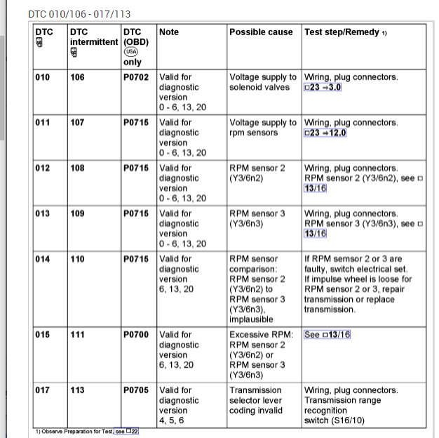

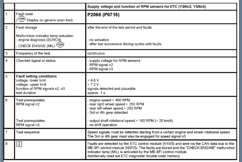

I don't think the code is related as that is a speed sensor issue but did you clear it and it come back after this happened again?
If it did then it is related and we need to chase it down.
I attached some info on this code below if that is the case.
Let's start with this info and let us know what the fuel pressure is when this happens and we can go from there. If this is transmission related then that code should come back.
