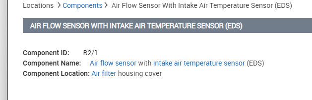

My car is a 1989 Mercedes 190d. I do not think it has an output for a code reader. I'm not sure if it has a mass air flow sensor or a manifold pressure sensor.
Apr 7, 2022 at 4:16 AM
Correct. Your vehicle is what is known as OBD I and does not have the port under the dash. That started about 1995.
Also, you have an air flow sensor with the intake temperature sensor so this is traditionally called a mass air flow sensor.
Take a look at the info attached for more detail.
Thanks
