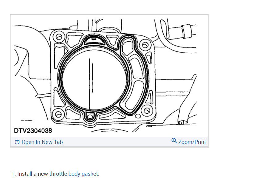

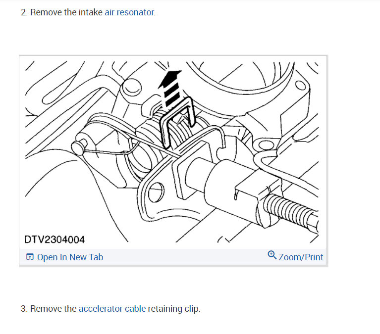

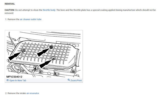

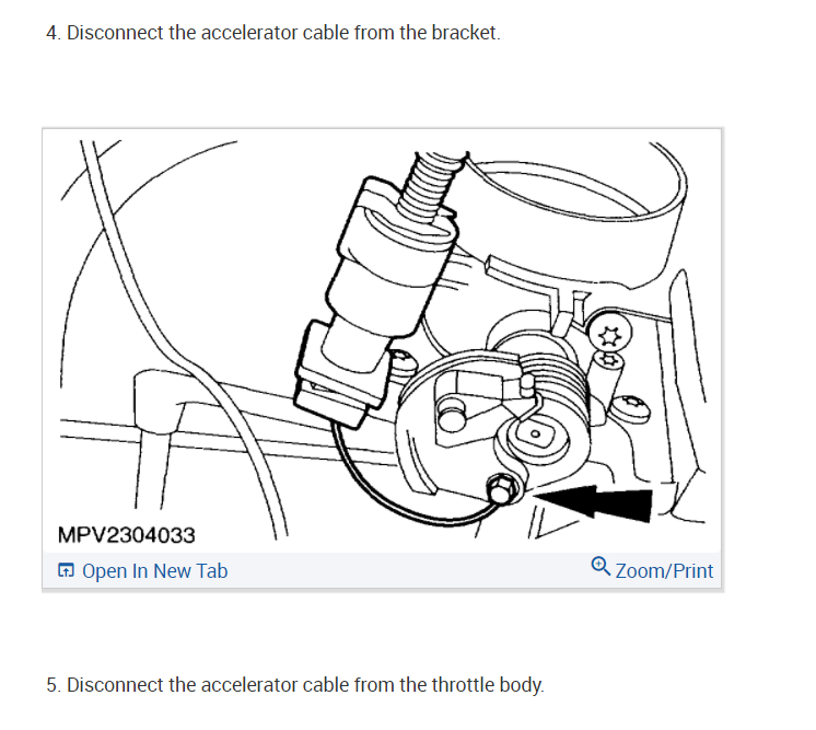

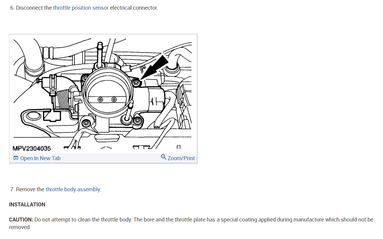

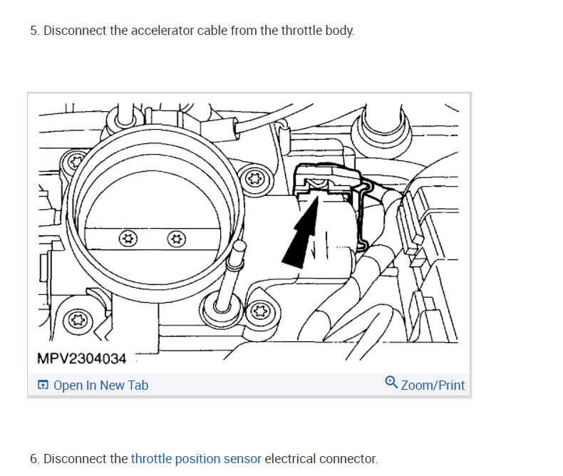

while in drive engine revs up, while stopped with foot on brake engine revs high. while in park no issues with idle.
Oct 10, 2021 at 6:14 PM
Experienced Mechanic
52,796 POSTS
Good morning,

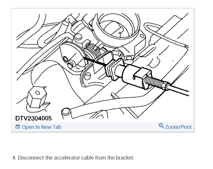

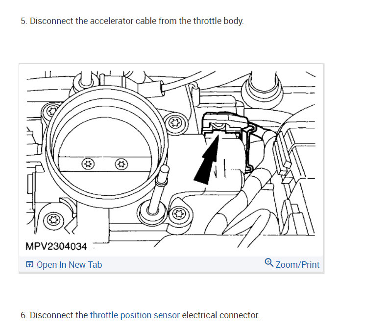

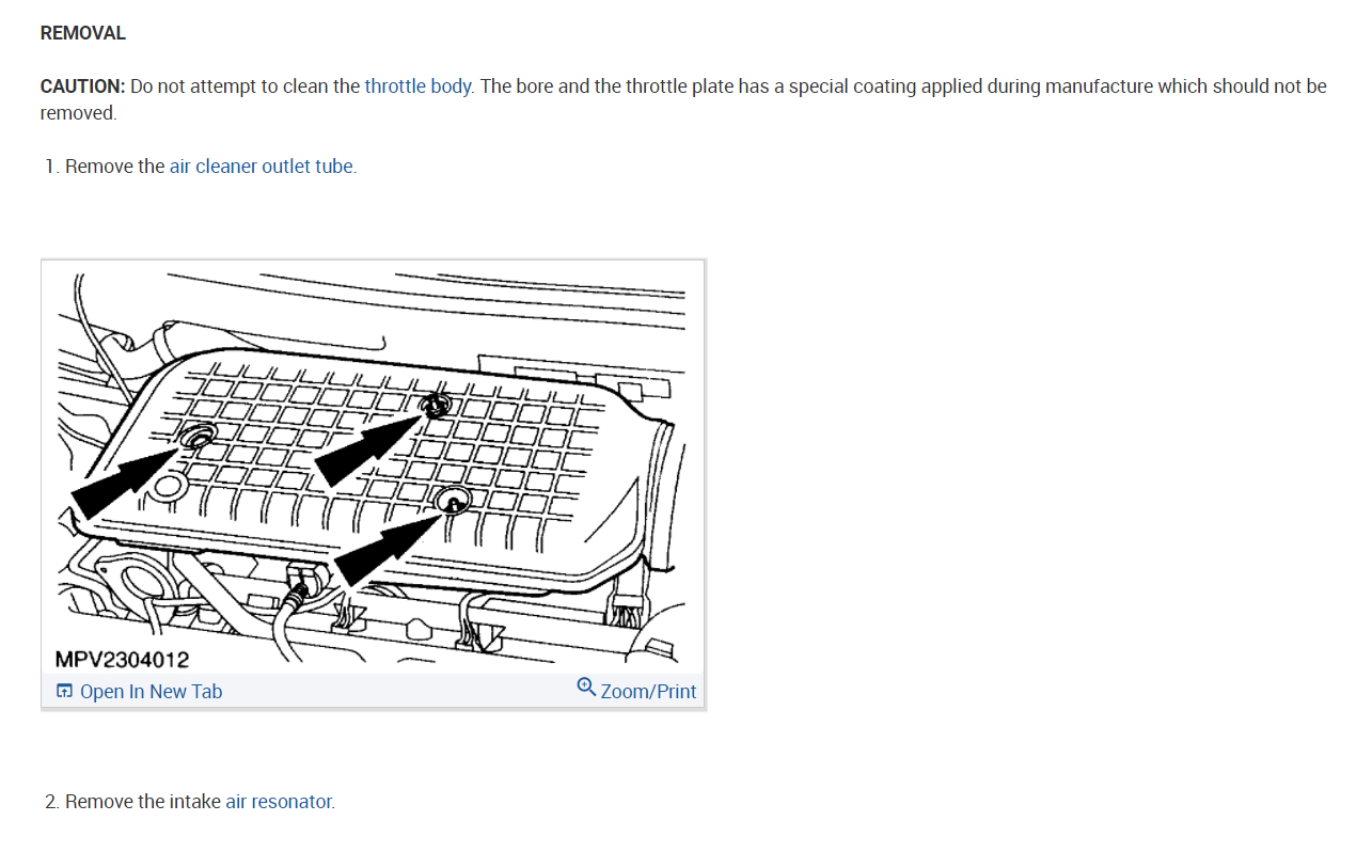

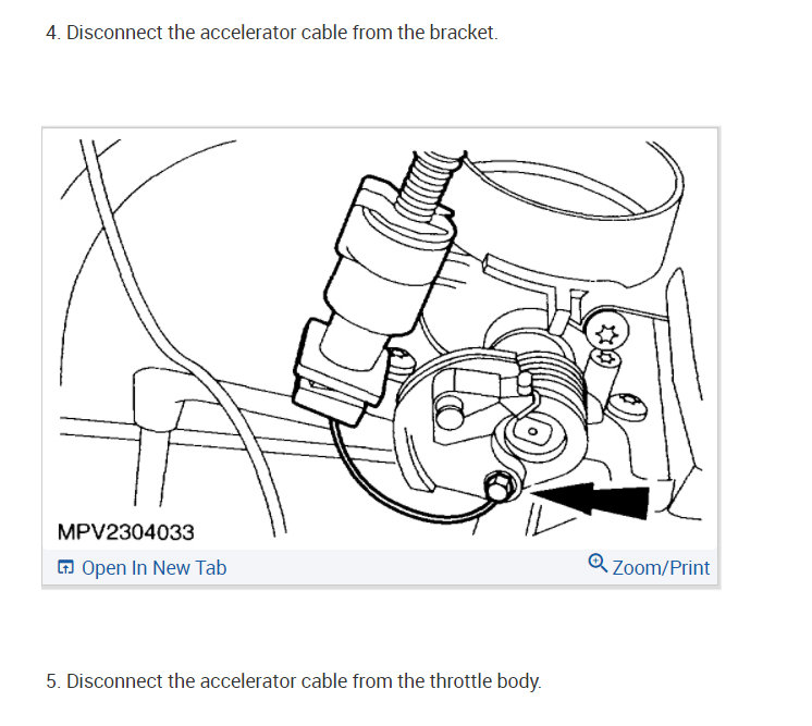

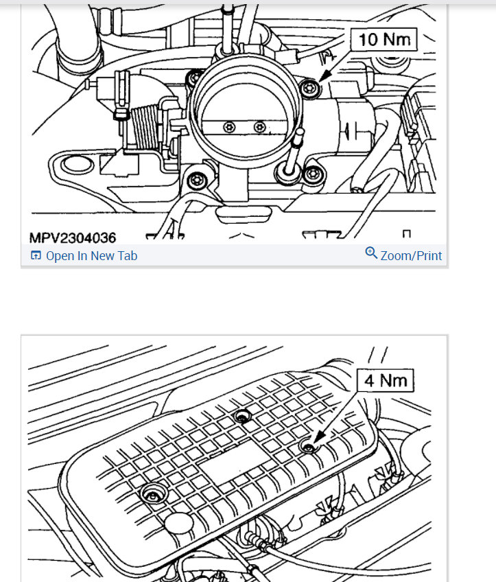

This sounds like a throttle body issue not regulating the idle as it was designed to do.
https://www.2carpros.com/articles/engine-idles-too-high
You can try cleaning the throttle body to see if it helps but if not, then it will have to be replaced. I attached the instructions for you below.
