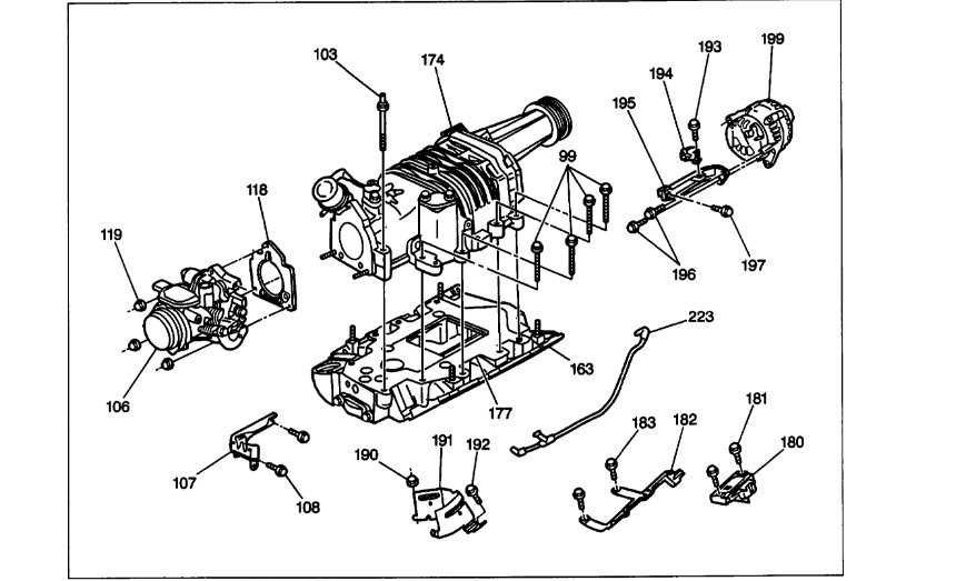

If it is in the supercharger, you will have to remove it to disassemble it.
Anything in this picture?

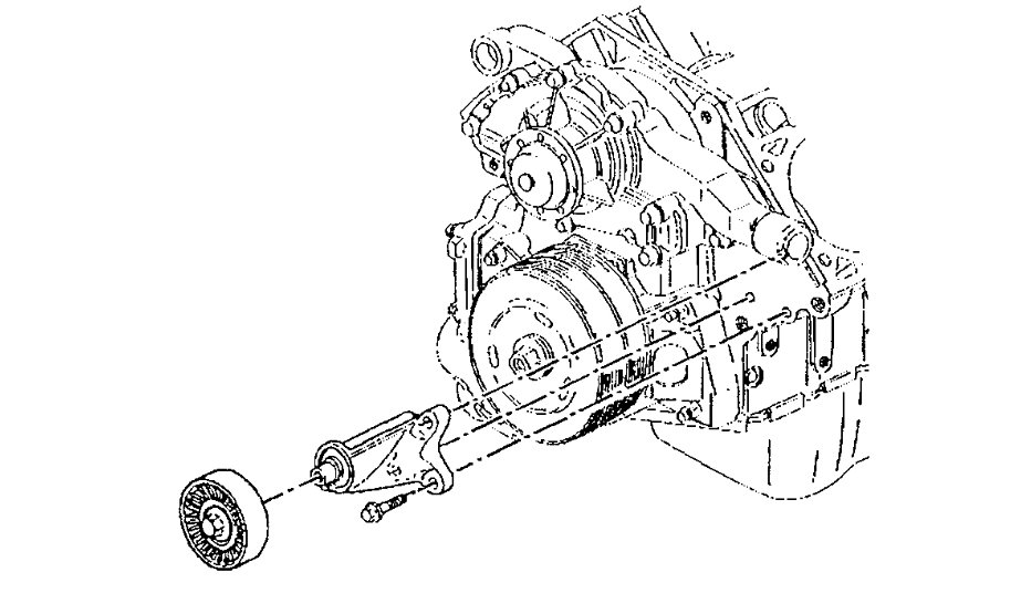

It is the guide pulley behind the motor mount.
Sep 1, 2018 at 1:27 PM
Can you post a picture for me to view?

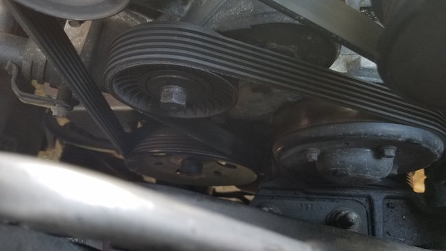

DANOTURBO59
  • 16 POSTS
Here is best I can get:
Sep 1, 2018 at 1:44 PM
So it is a pulley like the one for the alternator belt?

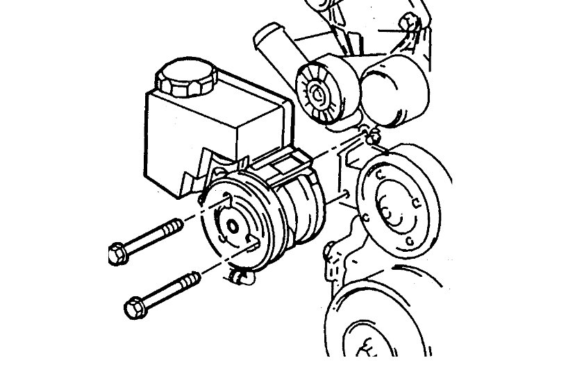

The power steering pump is in the way of the last bolt any comments on removing it with the front wheel drive?
Sep 1, 2018 at 1:48 PM
Is it one of these?
Sep 1, 2018 at 1:49 PM

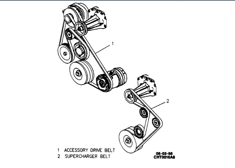

The pulley is gone it fell apart.
Sep 1, 2018 at 1:50 PM
DANOTURBO59
  • 16 POSTS
It is the in right next to the crank on the super charger diagram.
Sep 1, 2018 at 1:52 PM
You will need to drop the power steering pump. There are two 13mm bolts holding the pump to the block. You can access them through the holes in the pulley.
